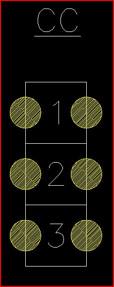

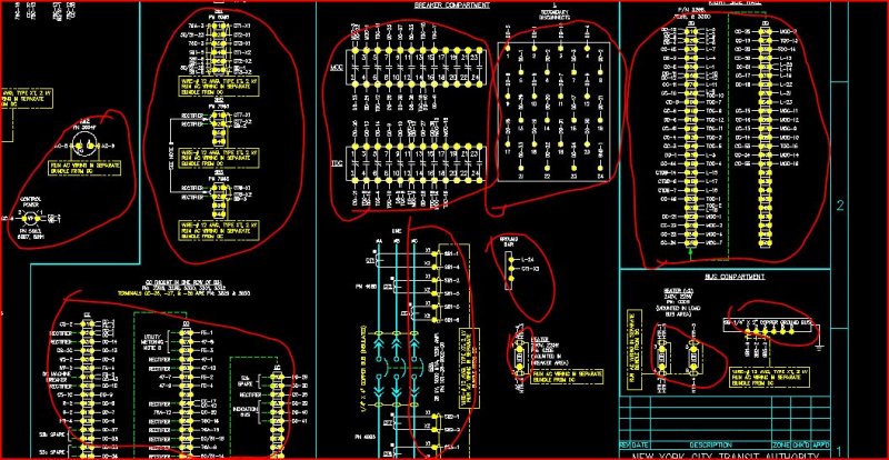

Agent 31 Posted October 13, 2010 Author Posted October 13, 2010 If anyone wants the full LISP I will be happy to send. There are 3 files, and they are all kept in the support directory of AutoCAD. The .lsp, the .dwg and the .dcl.... I was just wondering, David, but what doesnt make sense? I am including an image of what this LISP routine creates exactly, and a zoomed out version of just how extensively we use them. The yellow dots are the blocks I am trying to insert as a stand alone instead of having one already in the drawing. The point is, I can not get it to insert the yellow dot. While this is easy to correct, just copy one over to the drawing, run the lisp then delete it, I am looking for a way to do this in an automated fashion. This is to make it error proof so if someone who does not know the system is using the program, they will not have to worry about the ins and outs, they can just "click it and forget it". Quote
