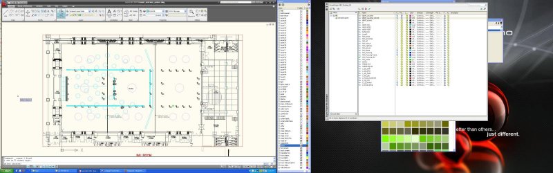

StephanBotha Posted October 13, 2010 Author Posted October 13, 2010 Hi, Thanks for that. It definitely got me going in the right direction. For some reason though, when I use DIVIDE, it doesnt create evenly spaced points. Some are much close to each other that others. I'll quickly upload a screenshot Quote

StephanBotha Posted October 13, 2010 Author Posted October 13, 2010 And here's the (sort of) end-results: The little circles are the tables, the big ones are the chandeliers from the ceiling. http://i53.tinypic.com/2dw8ffp.jpg Quote
