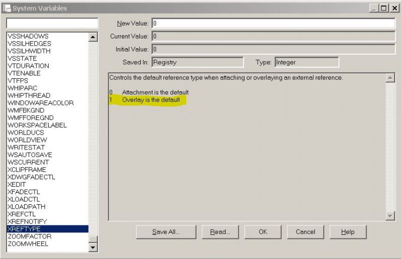

Might either of these system variables provide any relief?
Overlay vs. Attachment will not affect draw order but DRAWORDERCTL looks interesting.

If you look at the SYSVDLG description of DRAWORDERCTL in post #7, you may want to try setting it to 3, which claims to (while risking editing speed) provide full draw order display and drawing order inheritance.
DRAWORDERCTL=3 here and NO problems with keeping my Aerials behind the line work.
