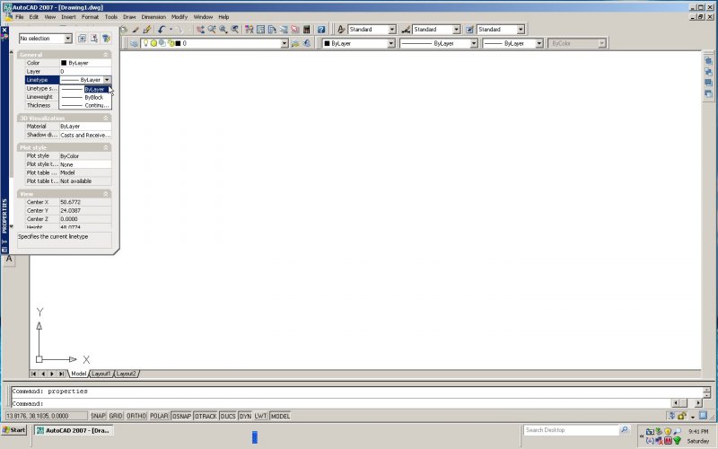

I have just started using v2007 and I am wondering how to get a hidden (dotted line) line as a default into my Modify Properties utility. I have included a screen grab
to show what is included in the drop-down menu.
Thank you,
Ami
Is the hiddened linetype loaded? If not, type Linetype, Load, then choose the linetypes you want to use.
