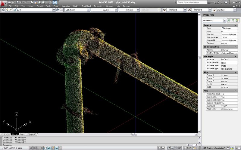

There is an application of AutoCAD called "Point Clouds" of software house Sycode.
It 's a paid software, but once installed it allows you to make 10 free runs or for 10 days.
I tried to test it on a tube with a pointed LaserScan.
I modeled the pipe with only two "bas-relief" (in reality it would take many more) and although I have not had many opportunities to experiment, I think that is accurate, and has never generated errors.
Regards

Hi Oliver,
generally when you use a software modeler is very important not to have too much difference between the scale of the model and measurement units sistem. It's also very important to not have the model away from the origin, to reduce the possibility of generating errors in the forms.
"(points coordinates may be too large - move closer to 0, 0 and/or scale down) "
This is a message that tells you the DTM lisp?
Hi Nuttieke,
"I tried it, But The contour lines are not accurate enough, I think."
It 's true, if you need precision the only sure method is the triangulation with the DTM.
They are also precise the curves obtained with the lisp AC (autocurve).
If you need a accurate solids you must obtain directly from 3DFACE of DTM.
Mesh and the Loft, are only approximations ...
Useful for presentations, because they have "clean" geometries of wire mesh and smooth Loft solid.
