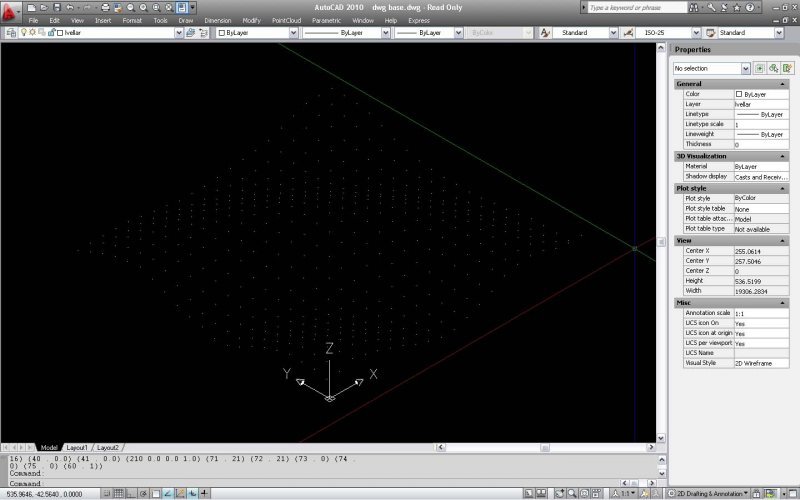

qball Posted October 8, 2010 Posted October 8, 2010 is it possible to create a surface quickly in Autocad using 3d survey points on a DWG? The way I did it was 3dpolylines and then lofting the surfaces. Quite time consuming. Hoping for a faster way. Quote

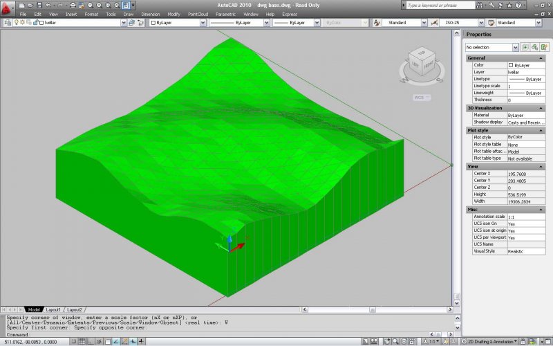

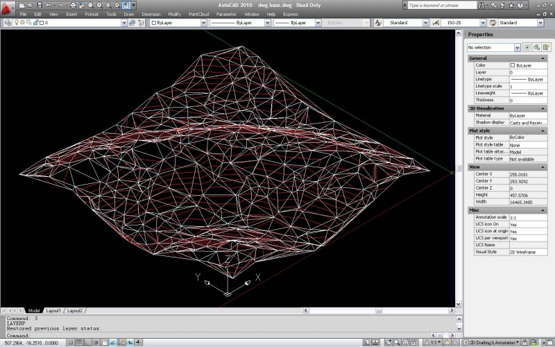

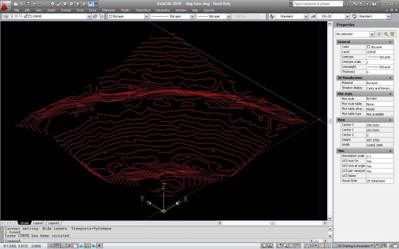

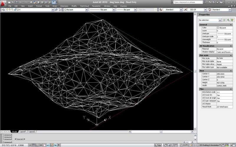

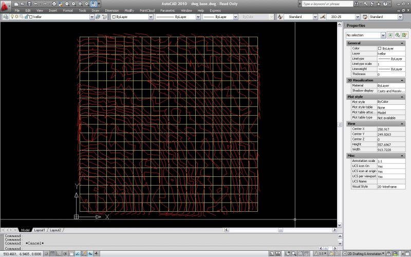

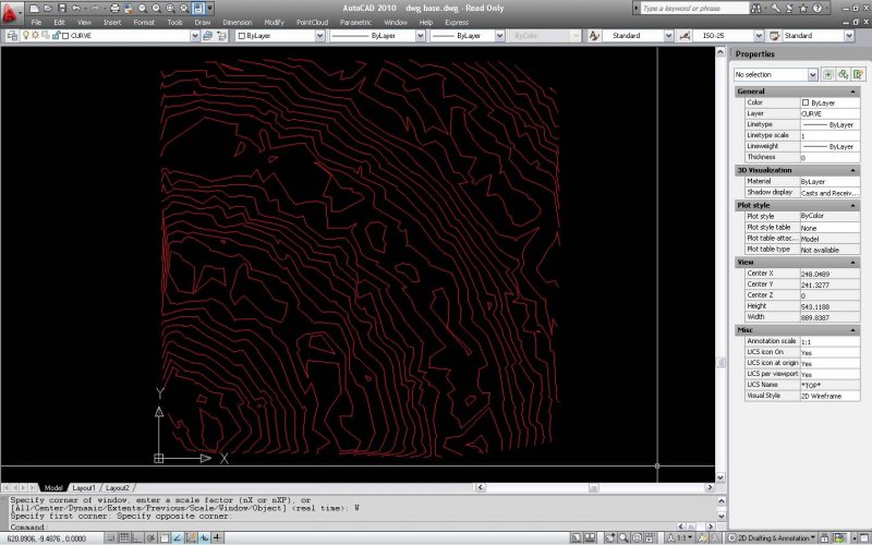

marmo Posted October 9, 2010 Posted October 9, 2010 Step 01_ lisp DTM: If you have a cloud of points you cant triangulate points with 3dface. Step 02_lisp Autocurve: You can draw curves on 3dface of DTM Step 03_lisp LV_curve to mesh: Step 04_famous lisp M2S, mesh to solid: File zip with commands lisp: 01_DTM_AC_C2M_M2S.zipFetching info... Quote
marmo Posted October 9, 2010 Posted October 9, 2010 Lisp curve to mesh works only with line: need to explode pline obtained with Autocurve. Quote

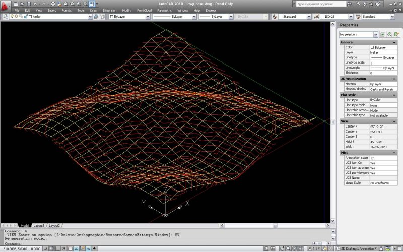

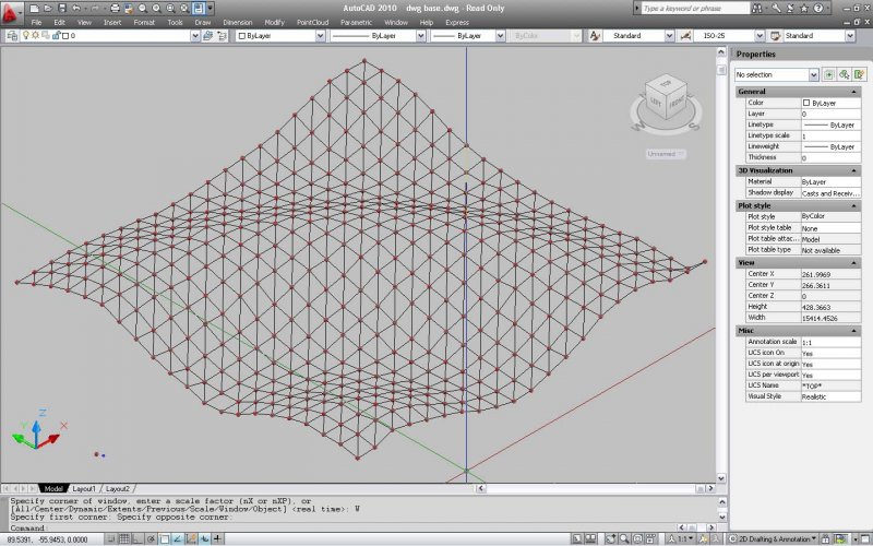

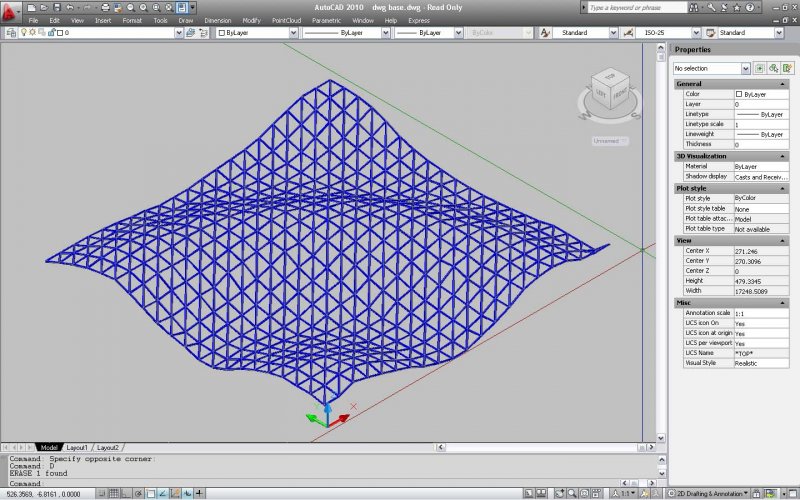

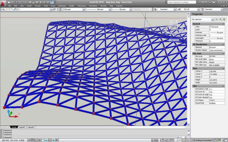

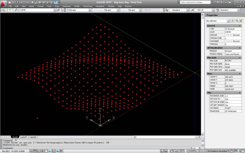

marmo Posted October 9, 2010 Posted October 9, 2010 Step 01, lisp mesh 2 point --> If tou have a mesh, obtained with previous posted lisp, or EDGESURF, or a primitive mesh object you can insert points on al vertex of mesh Step 02, lisp nodesert --> After you can insert block or 3dblock on obtained points. Step 03, lisp sweep with multipath --> You can explode mesh, convert 3dface in surface and extract edge (after use overkill of express tools) Zip files with lisp: 02_M2P_NS_SWMP_ZETA.zipFetching info... Quote

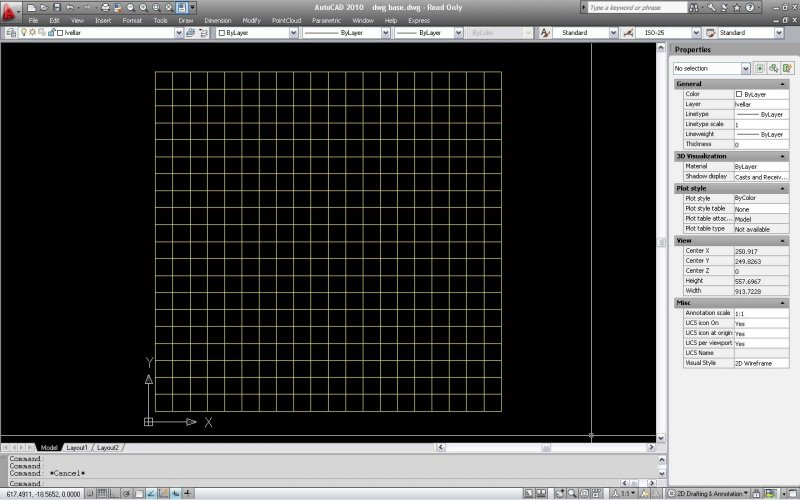

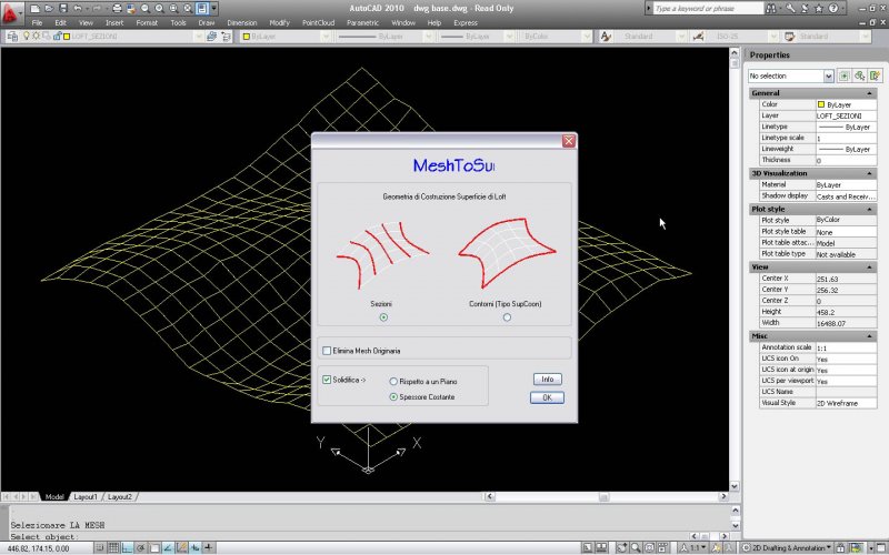

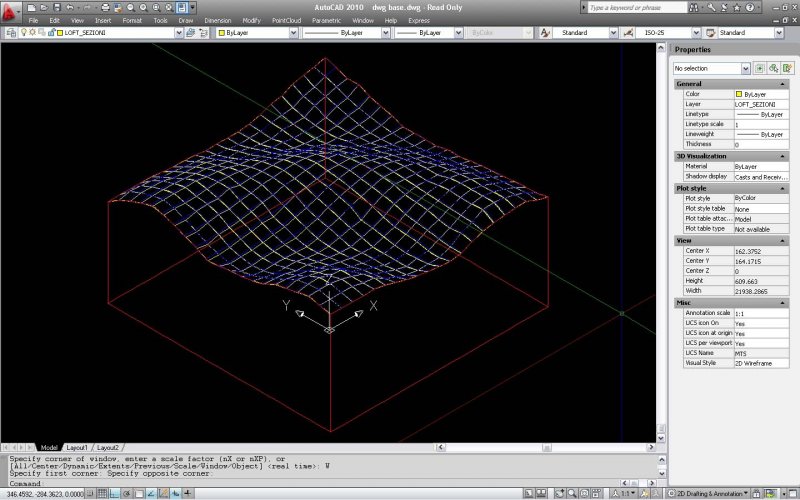

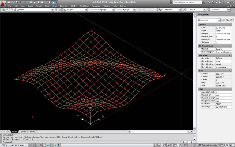

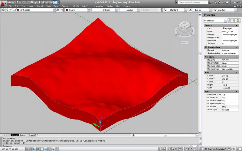

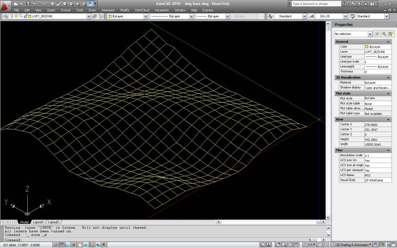

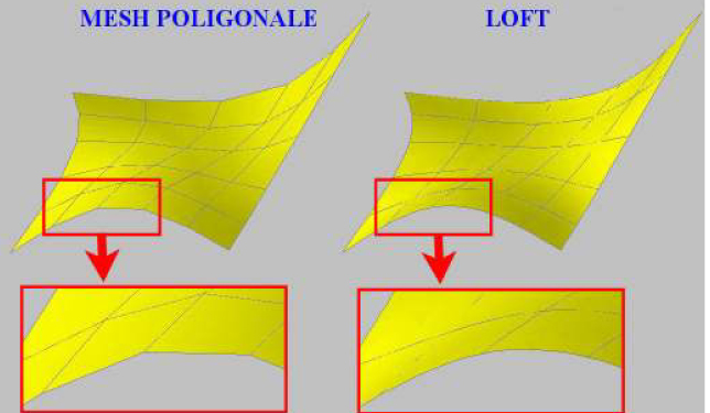

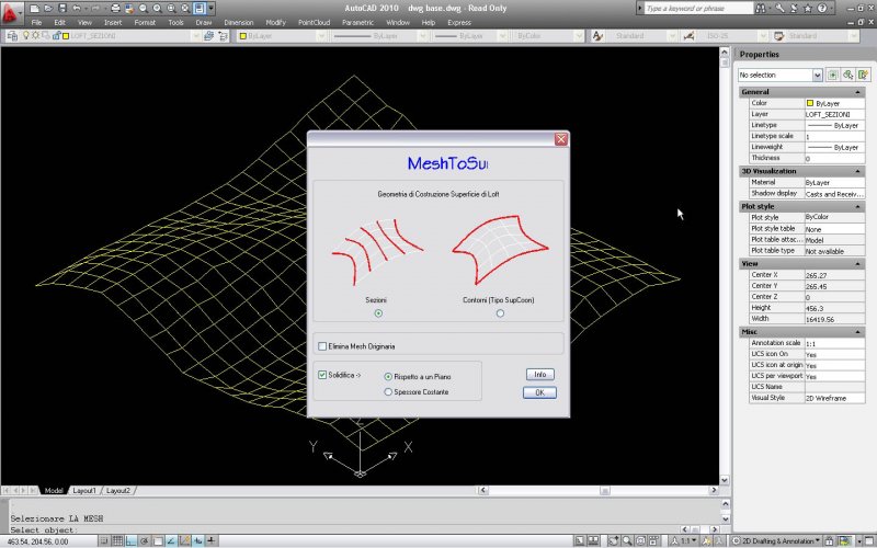

marmo Posted October 9, 2010 Posted October 9, 2010 I apologize: lisp is in italian language and i'm not able to modify for translation. But I decided to post it because it works differently than MeshToSolid lisp. You have your mesh: With ths setting: With this setting: Red = solid Blue = loft surface Yellow = loft section File zip with lisp: 10_MeshToSurf.zipFetching info... Quote

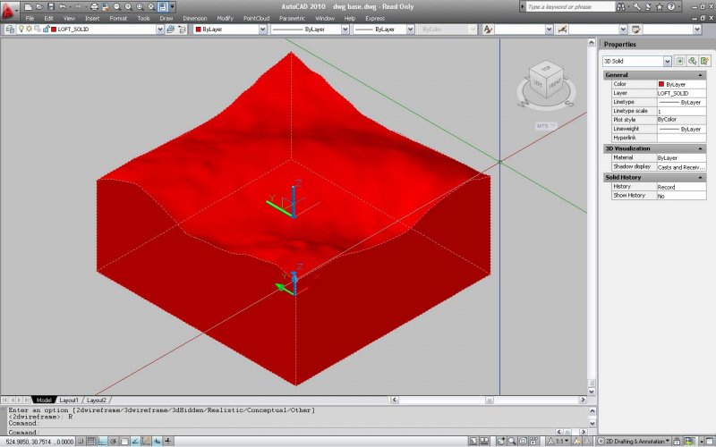

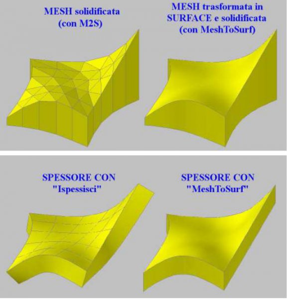

marmo Posted October 9, 2010 Posted October 9, 2010 Difference between mesh an loft surface Difference between lisp M2S and MeshToSurf (above) and difference between command Thicken ("Ispessisci" in italian) and Ticken by MeshToSurf. Quote

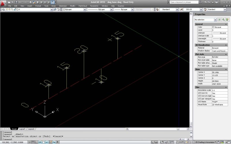

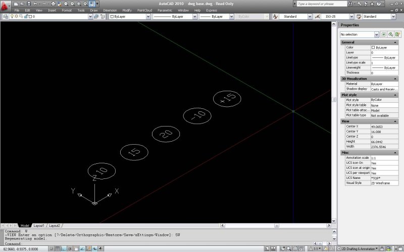

marmo Posted October 9, 2010 Posted October 9, 2010 At worst you can have only a block with attribute that indicates the Z of the land. This lisp is able to draw a point to Z given the TAG of the block. Lisp file: 04_ATT 2 POINTS_ENG.lspFetching info... Quote

marmo Posted October 9, 2010 Posted October 9, 2010 The triangle with the command DTM is accurate. Thus, such as the creation of the solid with the M2S lisp. The mesh creation or the Loft is approximate. Quote

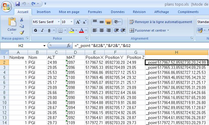

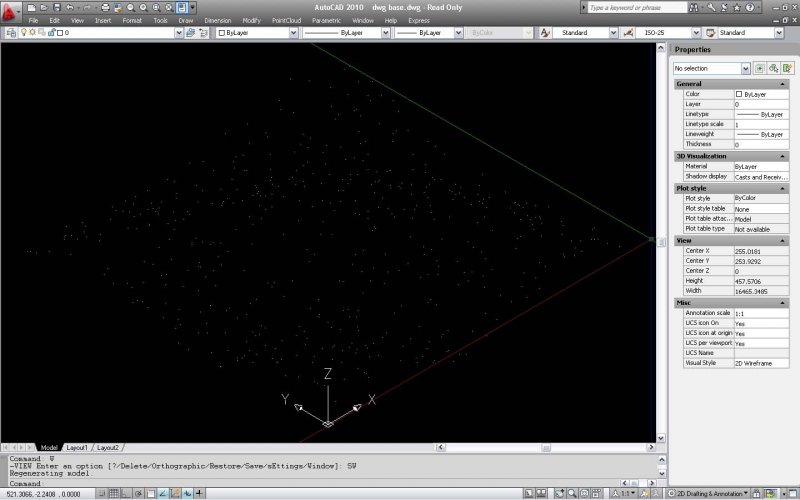

rvpas Posted October 9, 2010 Posted October 9, 2010 Hello, Great method for triangulate a terrain, to complete, you can use Excel or the other one to create a script. 1 - create an additional column and in this one types the following formula: ="_point "&E2&","&F2&","&G2 see image (cells value depend your table) Pascal 2 - copy out your formula up to the last point 3 - copy the column 4 - in Autocad, in the line of command, paste your list and there you will see Autocad creating automatically your points. The only difference it is because later, I use an add-in in Autocad FLASHCDN but who and paying to it and I think it only for french autocad version.see link (http://www.delicad.com/autocad/flashcdn.htm or http://www.delicad.com/anglais/flashmnt.php) At least the method of Marmo has the advantage to be free. thanks Marmo Good luck Quote
qball Posted October 12, 2010 Author Posted October 12, 2010 marmo, DTM worked the first time I tried, but now it says "Optimizing ... ; error: bad argument type: listp 352" . what happened? Quote

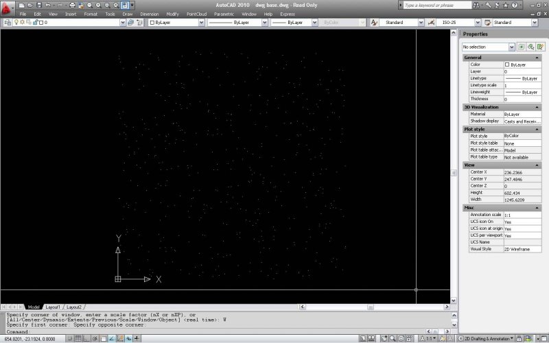

marmo Posted October 13, 2010 Posted October 13, 2010 Hello, I have not seen such an error. To me it has always worked. I just tried DTM trying to generate an error. For example, trying to select the points with even blocks, polylines, overlapping dots ... always works. Questions: 1 - with which command does not work: DTM, DTMRND, DTMFLOW or other? 2 - you are able to isolate the problem, limiting the selection to items that are the cause? 3 - With some commands, DTMZ for example, the lisp works if the model view is "TOP" and without perspective. 4-The program works with a maximum of 2000 points at a time. If you still have problems trying to post dwg. Regards Quote
qball Posted October 13, 2010 Author Posted October 13, 2010 there are 177 points. The error message comes up when I try to pick all at once. It seems to work if I do smaller segments at a time. So that should work for me. Strange though. Quote
marmo Posted October 14, 2010 Posted October 14, 2010 Hello, maybe just depends on the position of the points. The lisp of this type are influenced by the UCS, and thus the position of objects. I think it's a good idea to work for segments. To test the lisp you could generate a cloud of random points with the command DTMRND and try DTM with that cloud. Regards Quote

qball Posted October 14, 2010 Author Posted October 14, 2010 realsaint: after you've loaded all the lisps into the file and have your topo points: step 1: type DTM, select points - should draw 3dfaces step 2: type AC, select 3dfaces - draws contour lines step 3: explode pline contour lines as marmo said "Lisp curve to mesh works only with line: need to explode pline obtained with Autocurve. ", type LV, select contour lines then the lisp seems to freeze all layers and creates a mesh step 4: type m2s, turns mesh into a solid marmo, note that picking the smaller segments sometimes does some really goofy stuff. It's best to pick as many points as possible, but I don't know why there is an error sometimes. Don't know if it was mentioned before but if you need more than this you probably need Civil 3d, but this works well for what I will need it for. (I had to figure out retaining wall heights and tie-back concrete walls, etc, for an elevator in some big shot's house.) Quote
marmo Posted October 14, 2010 Posted October 14, 2010 Hi qball, The examples I posted are made of 500 points and I have selected only once. Have you tried the test of lisp with the command DTMRND, as I wrote in previous post? I attach a file with 2000 points. I designed the DTM with a single selection. Try it and let me know. If the point cloud is very complex (not in terms of number of points but the height differences) is not realistic to expect autocad return a task of interpreting the model. I think this is a problem that has to do even the software professional. Regards 2000pt.dwgFetching info... Quote
