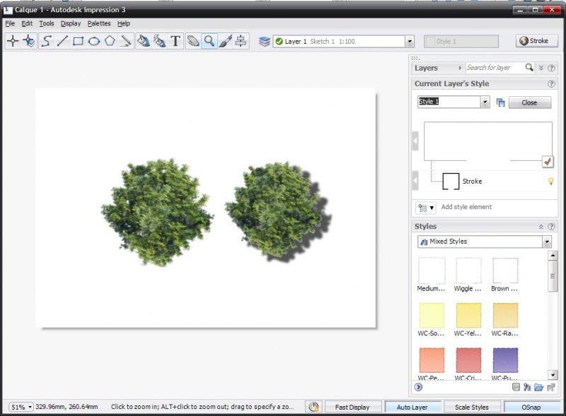

I'm trying to ween my office from PS into IL. A time consuming exercise I'm running into is taking things like trees to place on the presentation drawings. In PS they'd usually just get some photograph of a tree, then crop the surrounds off using the magic selection tool. Now we've got a huge library of these types of images saved in 32bit PNG (with transparency). It's simple using these in IL, but for the shadow effect - which won't follow the transparency. So I need to draw a border and then "fill" it with the image, tiled at 1x1.
Here's what I'm trying to do:

Do you create the shadow in PS/Gimp or in Impression? Very nice effect you have going. Here is a screen ggrap for those without Impression.
Let me play with that base png file and see what I can come up with. I would love to see some completed work.

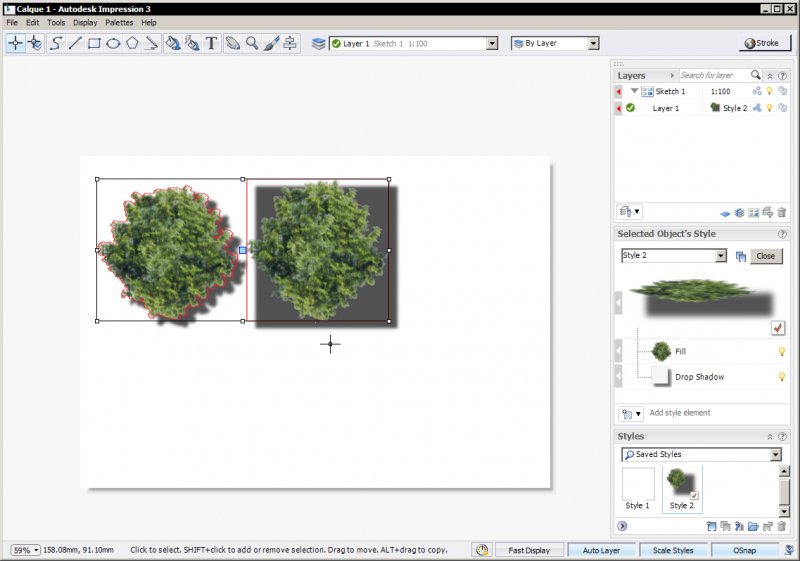

I created the shadow in Impression. If I made it through Gimp/PS then it would simply have been an image - i.e. if you rotated it the shadow would rotate with it. If the shadow is cast inside Impress - you have it pointing in the same direction no matter how you've rotated the block. The problem is Impress only throuws shadows from the borders of an object, so if you add a shadow onto a square image (even if the image has transparent areas) you end up with a square shadow. Here's what I mean. Notice the border around the one on the left. While the one on the right is simply a square, which makes the shadow square as well:

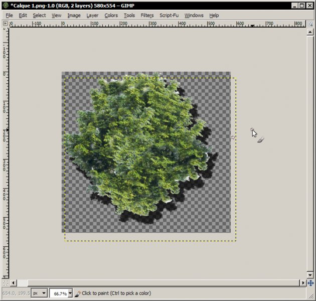

Now if I generate a shadow of the image in Gimp (which BTW is extremely simple to do):

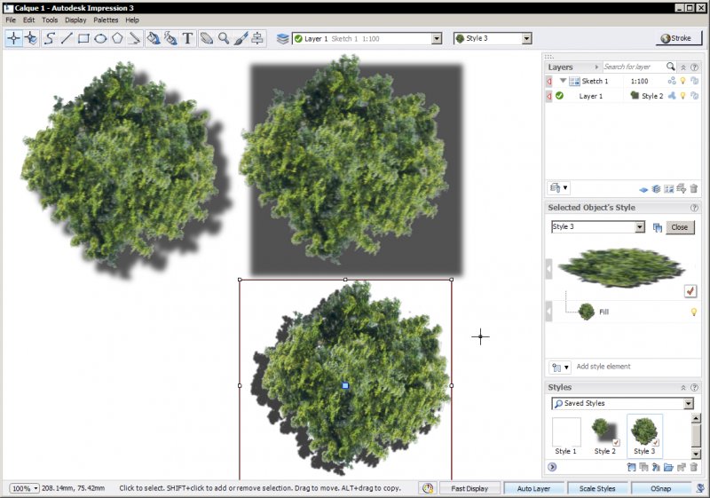

Then use that inside Impression, it looks correct until you rotate the thing:
