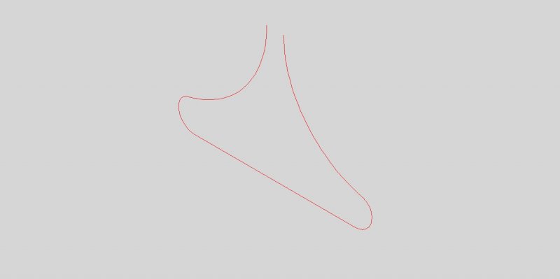

Bobzy20 Posted October 7, 2010 Posted October 7, 2010 Once again I'm trying to re-draw this item (see image below) but I'm finding it hard. Any ideas? (dwg file also attached) Thanks Bob Quote
ReMark Posted October 7, 2010 Posted October 7, 2010 Yes. Create the centerline profile then SWEEP a circle of the correct diameter along it and you are done. You have 7 minutes from now. GO! Quote
Bobzy20 Posted October 8, 2010 Author Posted October 8, 2010 Yeah I can extrude a 10mm diameter circle along the profile path when drawn but I would love some help drawing the profile. Teach me ReMark. (Please) Quote
ReMark Posted October 8, 2010 Posted October 8, 2010 OK, now I think you're just pulling my leg. The centerline, or profile path, appears to be comprised of a straight line and some arcs. Where could you possibly be having a problem? Your monitor is turned on isn't it? LOL Quote

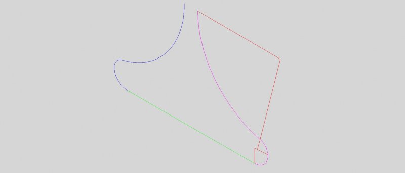

ReMark Posted October 8, 2010 Posted October 8, 2010 Is this some kind of test? Did someone put you up to this? Have we met in a previous life? Maybe the last time I was sent back to the future? OK...you win. I reconstructed the centerline profile. Now what? Quote

ReMark Posted October 8, 2010 Posted October 8, 2010 (edited) No special tricks were used to reconstruct the foot rail centerline. The one thing I did before I started was to rotate the foot rail so that it was straight up and down. After that I determined the centerpoint of each arc on one side of the rail. Once those three arcs were drawn and joined with pedit I drew the centerline of the straight section followed by mirroring the previously joined arcs to the other side. After that it was just a matter of sweeping a circle along each of those three centerlines. Give it a try and see what you can accomplish. Where are you digging up these "challenges" anyway? It's been a while since I posted this. Have you completed the task on your own? Time now: 12:27 p.m. Edited October 8, 2010 by ReMark Quote

ReMark Posted October 8, 2010 Posted October 8, 2010 I'll post an image that might help. Hold on. In the words of the Terminator... I'll be back! Does this ^ ^ ^ help? Quote
