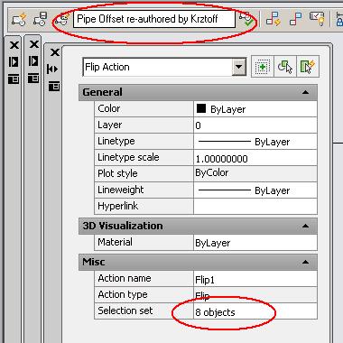

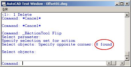

nestly Posted October 7, 2010 Posted October 7, 2010 (edited) I have a situation where a block will not stretch properly after it's flipped. The problem appears to be that my AutoCAD2011 is not including all the items in the flip action selection set. When I create the flip selection set, AutoCAD says it found 8 items, but only 7 show up in the flip action properties. If I use an existing dynamic block from someone else, that already has Stretch & Flip actions, I can modify the flip selection set to include all 8 items and the block works fine, however if I deleted either the Stretch or Move actions and try to re-create them, Flip will only "take" 7 in the new selection set, and the stretch action doesn't "flip" properly. I'm interested in knowing if anyone can fix the broken block in the drawing so it works when flipped, and if so, which version of AutoCAD was used? Thanks Offset01.dwg Edited October 7, 2010 by nestly add attachment Quote
Krztoff Posted October 8, 2010 Posted October 8, 2010 Hi, this seems to work fine for me. let me know if it's OK now. Offset01.dwg Quote
nestly Posted October 8, 2010 Author Posted October 8, 2010 Thanks Krztoff. Yes, it does work. I see that you have all 8 objects included in your Flip Action Selection Set, which is something I cannot accomplish. I've tried left-crossing windows, right-crossing windows, and picking the objects individually. My AutoCAD2011 finds 8 objects, but it always excludes one of them without any explanation, and that seems to be the problem. What version of AutoCAD did you use to redefine the block, because I'm starting to think the 2011 block authoring tools in 2011 have been changed. Quote

nestly Posted October 8, 2010 Author Posted October 8, 2010 I appreciate your help Krztoff. I have a similar thread going at the Autodesk forums, and between the two topics, I've pretty much narrowed it down to a problem with the Block Editor failing to include one of the selected items in the Flip Action. Window, Crossing window, Fences, WPolygon, CPolygon, BOX, Multiple, and Add always drop one object from the selection set. QSELECT > All is the only way I can get everything in the selection I need, and then I have to remove anything I don't want flipped. It seems I need someone with AutoCAD2011 to redefine the broken block I posted to see if it's a AutoCAD2011 Block Editor bug, or if I need to figure out what's messed up on my end. Quote

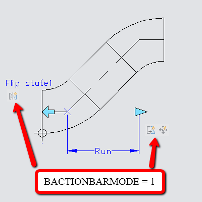

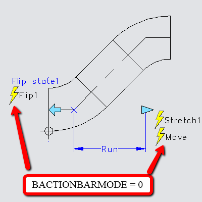

Zuluwarper Posted October 12, 2010 Posted October 12, 2010 The reason the number of objects selected are different in this particular block when editing in the AutoCAD 2010 and later Block Editor is because action objects are not selectable when the new system variable BACTIONBARMODE is set to 1. The missing object was the STRETCHACTIONENTITY object in this drawing. When BACTIONBARMODE is set to 0, then the legacy action objects are displayed and are selectable in the Block Editor. By setting BACTIONBARMODE to 0, then the STRETCHACTIONENTITY object can be added to the Flip Action's selection set and then the stretch will work as expected after the block has been flipped. Quote
nestly Posted October 13, 2010 Author Posted October 13, 2010 Zuluwarper is the Autodesk technician that's been handling my support request. Reverting back to the pre-2010 Block Editor actions does indeed seem to restore full functionality to the 2010-2011 block editor. I do prefer the cleaner look of the new action objects, so hopefully they'll fix them so they work like the older "lightning bolts" Pre 2010 style actions 2010-2011 actions Quote
