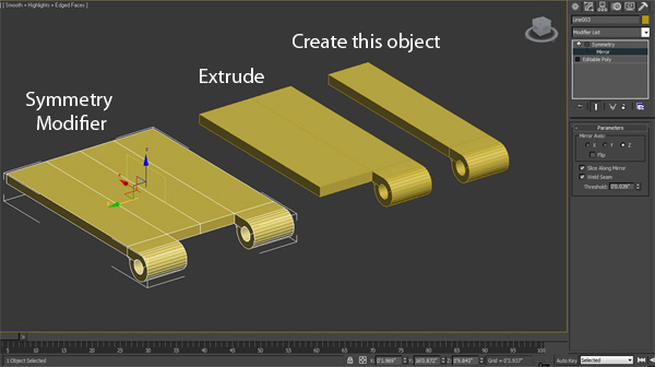

Akatszuki Posted October 21, 2010 Author Posted October 21, 2010 Cad64 said: Ok, I'll give you some hints. how do u make that small hole in the cylinder ? o.o Quote
Cad64 Posted October 21, 2010 Posted October 21, 2010 I explained the procedure of how to create a solid object out of a spline outline here: http://www.cadtutor.net/forum/showthread.php?53487-Extrude-from-a-line-drawing Quote

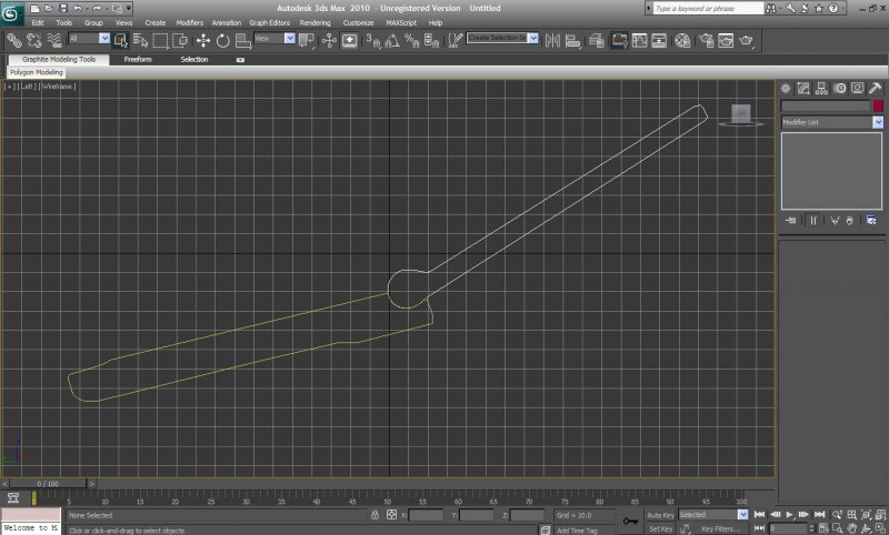

Akatszuki Posted October 21, 2010 Author Posted October 21, 2010 I made it until like that . so how do i extrude the lower part ? Like the one u show . (the top one) Quote
Cad64 Posted October 21, 2010 Posted October 21, 2010 Akatszuki said: so how do i extrude the lower part ? This is where poly modeling skill is required. If you don't know how to poly model then you can't create complex models. Have you been reading tutorials like I suggested? Have you gone through the tutorials provided in the Max Help menu? In order to extrude the lower part, you will need to cut poly's and move and weld vertices. It's a little complicated to explain. You need to study tutorials. Quote
