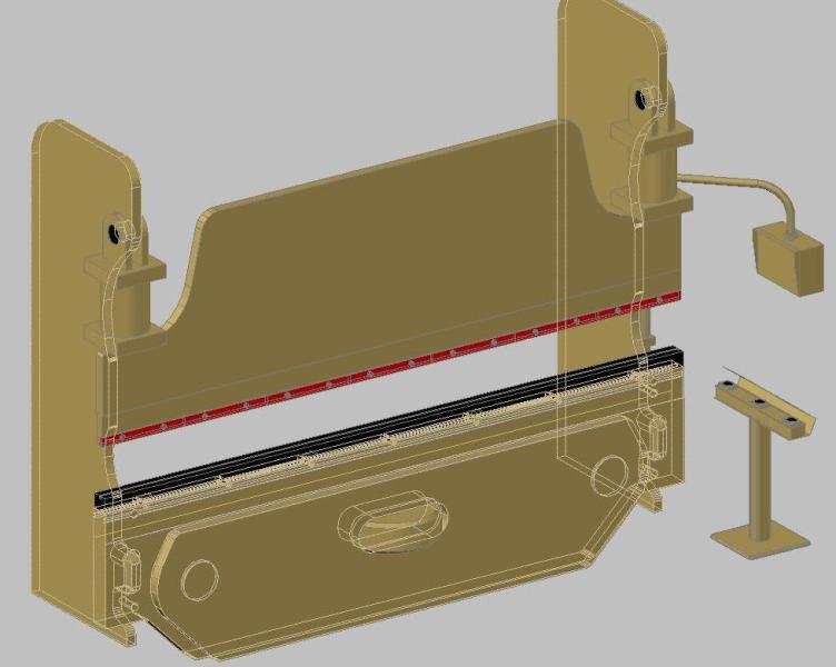

Frana Posted October 6, 2010 Posted October 6, 2010 Is there a way to "disassemble" a 3d model that has been joined together using union? For an example, viewing the pic, I have used the union command to "connect" a handful of 3d objects for easier movability in my model floorplan. But, after doing so, I find if I need to make alterations to one of these grouped objects, I can't break them back apart to their original seperate forms... Does this make sense? The only thing I can think of is to explode the object, but that makes way to much of a mess to clean up... Quote

ReMark Posted October 6, 2010 Posted October 6, 2010 It sounds like you didn't retain any of the underlying geometry (separate profiles) for the machine. Right? DO NOT EXPLODE IT! Hope I said that loud enough for you. Your only option might be to use the Slice command to carve up the machine into the necessary pieces. Do it on a copy and save the unioned original. Quote
Frana Posted October 6, 2010 Author Posted October 6, 2010 So, I guess the way it sounds once you've unioned two objects, without keeping original geometry, the originals are sorta erased? This is a bummer. The good news is, what I need to alter is a simple crane rail extension, the slice command will work on doing what I need, I was just hoping there was a way to revert back to those original individuals for other incidents that may come up... I will need to keep layers for backup original geometry I guess. I still think that there has to be a way? There's always more than one way, right ReMark? Quote

nocturne00 Posted October 7, 2010 Posted October 7, 2010 Sad but yes, after union,its foing to be difficult to split up to its original components. usually for simple geometry, I tend to use slice to separate, but in this case it would be better to redo it. but im not sure with the newer versions. pelase do correct me if im wrong. Quote
fuccaro Posted October 7, 2010 Posted October 7, 2010 First time I was faced with this problem I copied the drawing, than I exploded it and I recreated the solids from the exploded surfaces lines and arcs. A lot of work, I would say. Quote
marmo Posted October 7, 2010 Posted October 7, 2010 If solids are physically attached you have to use the SLICE command. SLICE allows you to cut solids. If solids are not physically attached to (this can happen at work) you must use the command SOLIEDIT> BODY> SEPARATE. For practical work instead join objects with UNION you can use GROUPS SELECTION, with switch ON/OFF the effect of variable PICKSTYLE (value 0,1,2 or 3). Another way: Try to use explode.. We have to do these steps: If you use explode obtain a lot of 3DFACE or Surface or REgions. If you have 3DFACE or regions must then be converted to surface. The surface, corresponding to the part you wanted to separate, should be merged with the Union command. Now you have one surface, which should correspond to the solid surface that you wanted to separate. The surface must be converted in solid. Quote
ReMark Posted October 7, 2010 Posted October 7, 2010 I think a lot of newcomers to 3D solids editting assume the SEPARATE command is the equivalent of an UNUNION command which it is not. We've even had people ask if there is such a command as UNUNION. AutoCAD users need to become familiar with the system variable DELOBJ. "Controls whether geometry used to create 3D objects is retained or deleted." The default value, which is saved in the Windows' Registry, is 3. This setting... "Deletes all defining geometry, including paths and guide curves used with the SWEEP and LOFT commands if the action results in a solid object." Users might wish to change the setting to "0" instead. This will retain the underlying geometry. Source: Quotes are taken directly from the AutoCAD Help file. Quote

fuccaro Posted October 8, 2010 Posted October 8, 2010 Also you can create a new solid that contains a part of the unioned solids. And use INTERFERE with the option to create new solid where the two ones intersects. Hard to explain... better give it a try. Quote
marmo Posted October 8, 2010 Posted October 8, 2010 Interfere! Good strategy! Very fast for subdivide complex models! Quote
