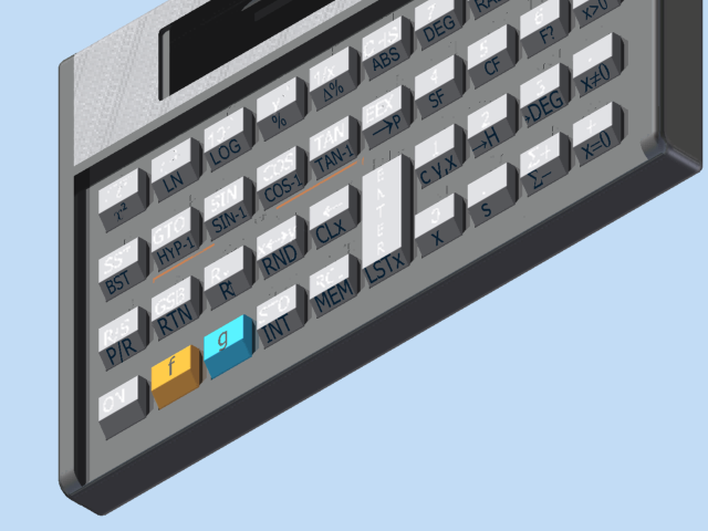

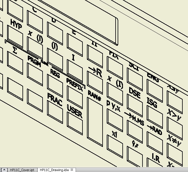

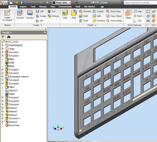

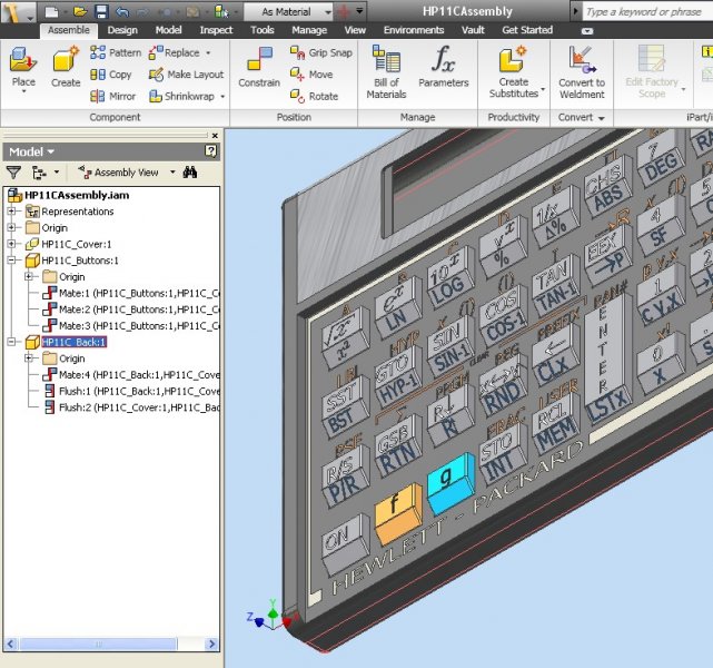

...All the text, coloured blocks and symbols are simple embossings with a raised height of 0.001mm....
I made a large sketch with all of the text and then went back and Embossed by selecting each individual text item.
Is this correct?
I like it because you can see the text on the drawing file, but it bloated the file 586KB even rolled up, so I cannot Attach it.

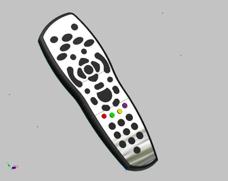

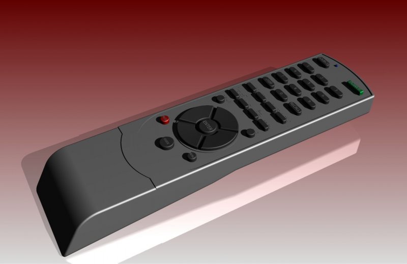

Well i have got this far with mine and the bottom bit is really getting to me...lol
anyway...
here's what i done so far .
I need to figure out 3d drawing because at the moment i am arcing and lofting and using the shape of the remote as the path ..it really doesn't look right :(,,,still i have a few weeks to sort it...lol
Steve
p.s cmon new bees have a go :)

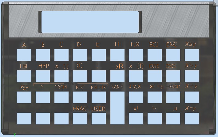

I am trying to Emboss text, but I can't figure out why I can see the text on the Model, but when I render it, the text disappears.
Screen shots have the inventor background.
The text that I embossed on the buttons seems to render OK, it's the Text on the cover plate that didn't work.
hmm strange. maybe emboss a bit deeper? or change the text colour? how have you guys gone about the buttons? done them as individual parts or as one part? hmmm unsure how far to go with it...
...how have you guys gone about the buttons? done them as individual parts or as one part? hmmm unsure how far to go with it...
I know that it's not technically correct, but I did the buttons as one part, and then changed the properties on a couple of the extrusions to change their color. I like how you can do that even though it's part of an array.
Thank you Dave I have learned something today, thank you for share this information.
You can see them there(very faint) so the issue is a lighting and depth issue. You might consider changing the color of the face(one selection) to a slightly lighter color. That will make the emboss stand out a bit more. If you add a presentation background as well as play with the lighting i think they will show up better.

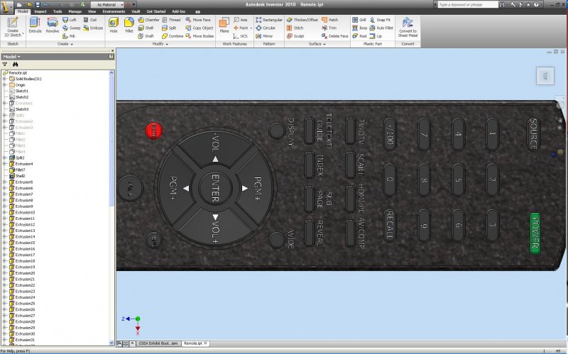

Hi Guys,
Just want to share what I have created. Using multiple body feature.
Problem:
1. The font embossed doesn't seem to be showing nicely after render.
Edited by CAnnondale
Hi Guys,
Problem:
[ATTACH]23784[/ATTACH]
[ATTACH]23787[/ATTACH]
Nice work will,
I have also taken the multi body approach to this task. As for the rendering try changin the lighting or extruding the emboss a bit more this should help... :)
Thanks Rob
Nice work will,
Thanks Rob
Thanks Rob. I will give it a try. and more trial and error...:lol:
Nice work ...the rendering makes a whole lot of difference.
