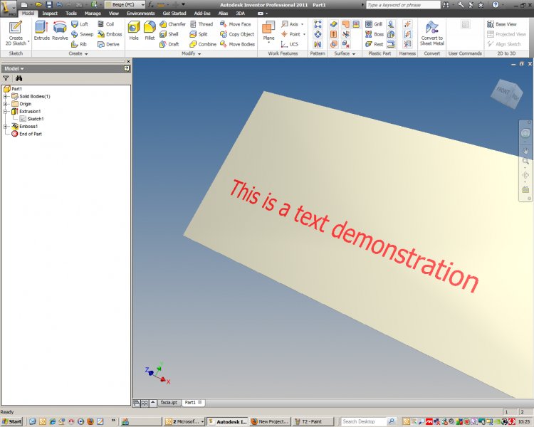

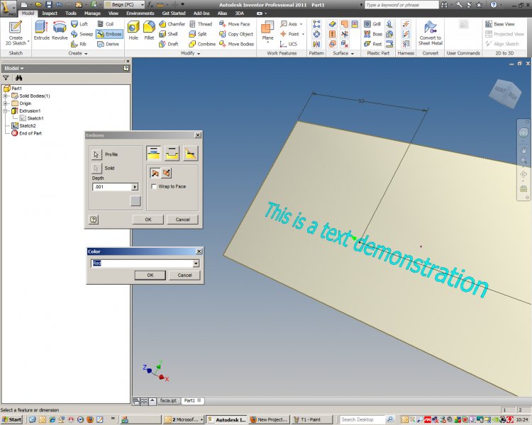

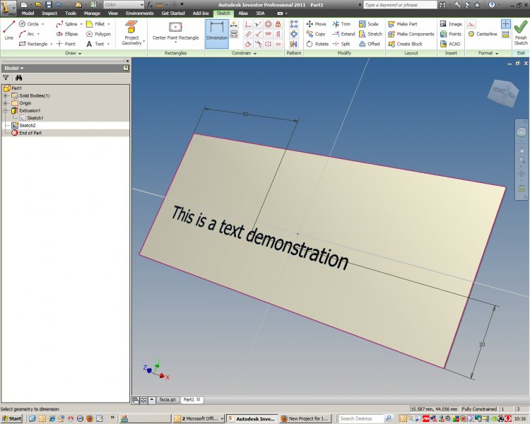

Hi Dave, just a quick one, how did u get all the symbols etc. for your remote. and for the coloured blocks are they separate sketches? or is it a projected image?
thank rob
Hi Rob,
All the text, coloured blocks and symbols are simple embossings with a raised height of 0.001mm. The text embossing was done in several stages because the text height is not constant. When characters were missing from the font alphabet I created what I needed by making suitable sketches. Luckily I only had to do this for the arrows and square symbols.
When you place text within a sketch you can of course select, height, font style, justification, underline, italic, bold, stretch, etc.
You may not know that after placing the text if you right click on it and turn off the "text box" you will find that a green dot appears at the point you have previously chosen for justification. This point can then be dimensionally driven to accurately locate the text in relation to features, cut-outs and other text. You can of course use horizontal and vertical constraints as well.
After that it is a simple emboss, at which point you can select a colour for the emboss, the direction it operates, i.e. cut or raised and if you wish "wrap to face."
Be advised that if you mirror an embossing the colour will disappear and need re-applying to the mirrored object, so don't think it has not worked, move your cursor over where the mirrored emboss should be and it will highlight, you can then select the face(s) to change it's colour properties.

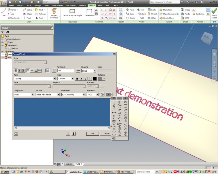

As far as symbols go there are some available to the user when placing text (see picture). To get these you just click on the box indicated and cycle through the options. Hopefully what you need is there, if not you will have to sketch your own.
Dave
...and at the bottom left of that image of available characters Dave posted there is a link to the Windows character map for about anything you could need.
J.D. is quite right, and I should have mentioned that. Unfortunately he is incorrect about it containing "about anything you could need."

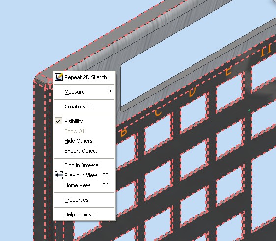

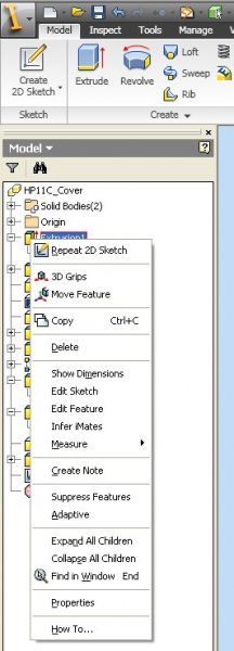

How do I Hide everything except for Feature6? (The brushed aluminum faceplate)
I want to shell the Feature6 with Excluded Faces, but the other Features are in my way.
Or I can extrude a slice out of it to make it thinner. If I suppress everything goes away. I just want to toggle visibility.
HP11CZipped10-07-10.zip
you can right click parts in your feature tree and turn the visibility on and off? is that what you are after?
AHHH i get you so you want to use the geometry from your base to extrude away the material on the face platE?
Yes,
I see I can deselect the visibility if I right click on the part, but how do I get it back. I don't see the option for visibility on the tree.
Thanks
I found it, Right click on something else and select... show All :oops:
