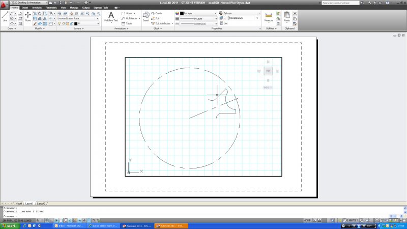

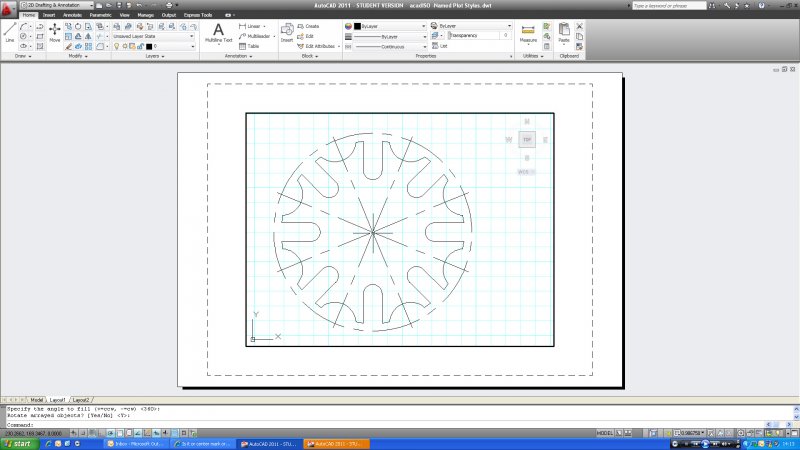

Depsas98 Posted October 4, 2010 Posted October 4, 2010 I'm trying to get to whats pictured with the red outline. The best I can figure out after messing with settings for 2 hours is the second pic. How in the world am I supposed to draw this? Thanks. Quote
rkent Posted October 5, 2010 Posted October 5, 2010 (edited) You draw a center line from the center of the main object through the hole, then a bolt hole centerline circle. In hand drafting you can get it drawn the way you show but with cad you just have to live with what you get. You could start breaking the circle and so on but I wouldn't recommend that. Edited October 5, 2010 by rkent Quote

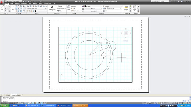

Grant Posted October 5, 2010 Posted October 5, 2010 Try doing an ARC in your center layer Type arc - End Point - Center Point - End Point In the end you will have an arc to the circle (bolt hole) another arc through to the other side of the small circle (bolt hole) and another arc after that. Quote
fuccaro Posted October 5, 2010 Posted October 5, 2010 An "Arched center mark" could be an interesting subject for a dynamic block. Unfortunately I don't have AutoCAD right now to create one Quote
Cat Posted October 5, 2010 Posted October 5, 2010 Looks like they just offset a circle and put it on a layer using centerline as the linetype, but then again, you wouldn't necessarily get the perfect crosshair in the center of the circle. You might be able to fudge it by making your center marks smaller. Quote
Tiger Posted October 5, 2010 Posted October 5, 2010 I would guess that they have used Break on the circle running through the hole and changed the linetype of the piece of line inside the hole. If I had done it, I think I would have made the entire circle running through the hole as center-line (i.e dash-dot) Quote

ChrisGrady Posted October 5, 2010 Posted October 5, 2010 I had to draw something similar on my training course which was a mechanism drive - could you not draw one section of the mechanism and use the array command to complete the circle then you should have a centre line to add a circle on to? maybe like this? then use mirror command and the array command then perhaps you wil be able to draw your circles on the centre line maybe thats not what your after but thats my understanding of it Quote
ReMark Posted October 5, 2010 Posted October 5, 2010 Chris: Nice sequence. However, the point of the conversation is really about getting the radiused center mark as depicted in the very first image posted by the OP. Quote
ChrisGrady Posted October 5, 2010 Posted October 5, 2010 My apologies ReMark - I misunderstood the point!! Quote

nukecad Posted October 5, 2010 Posted October 5, 2010 (edited) I do this sort of thing all the time for pipe flanges, etc. Yes that first image has been drawn by hand but you can obtain the same effect on CAD. First using a centreline draw a circle at your PCD and where it crosses an axis draw your hole. Now trim the PCD to the hole and EXTEND the ends by the same amount each end. Doing this ensures that you get an arced centreline equal about the axis at the hole centre as in your first image. You can now use the ARRAY command to get the number of holes that you need. Not quite the same as your image as there is a centreline arc at each hole, but that is the standard way of doing hole centres anyway. Edited October 5, 2010 by nukecad Quote
