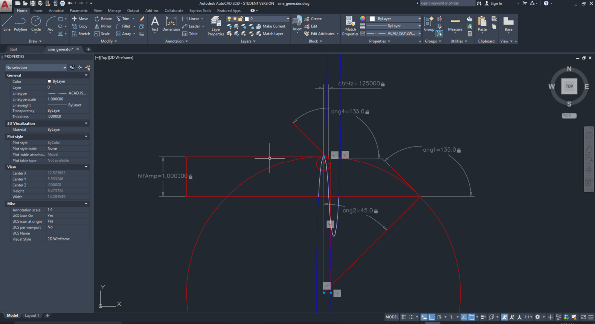

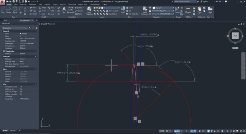

raed Posted November 2, 2020 Share Posted November 2, 2020 (edited) I know this is a super old topic, but I've been looking for something like this. I ended up coming to my own solution for parametric sine/cosine waves using contiguous ellipse arcs with an apparatus of parametric construction geometry to define osnaps for each axis of the unit arc. However the only parameters I could figure out to create, and which I think might exist with a setup like this, are the amplitude and frequency - no damping or anything like that. Additionally I just came across this: https://www.cadstudio.cz/en/apps/2dplot/, which looks like it might be really for providing appropriate fidelity and additional parameters such as damping. sine_generator.dwg Edited November 2, 2020 by raed not quadrants Quote Link to comment Share on other sites More sharing options...
