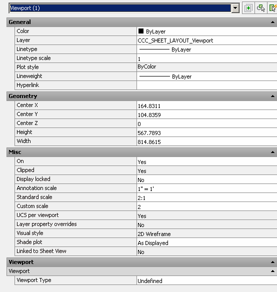

Can anyone help with this? I am trying to get the viewport scale?
I tried that David and while I could see the variables I didn't know what I should be looking for.
What were the values? -David
David,
This is what the code gives back:
Command:
The VIEWPORT Scale is 1 = 0.9657
b = nil
c = nil
vs = 548.295
vps = "0.9657"
Press Enter To Continue:
And this is the actual viewport scale
As long as b & c return nil, your program cannot work
You do not have test for (equal 0.9657 (/ vs ys) 1e-4) and I would not think that to be a proper scale.
As you see the Height and vs values do not match. They should.
It may have something to do with custom scale that is set in the 'Misc' data box. I know nothing about what it means or how it is set?
Maybe someone can jump in a different view. -David
