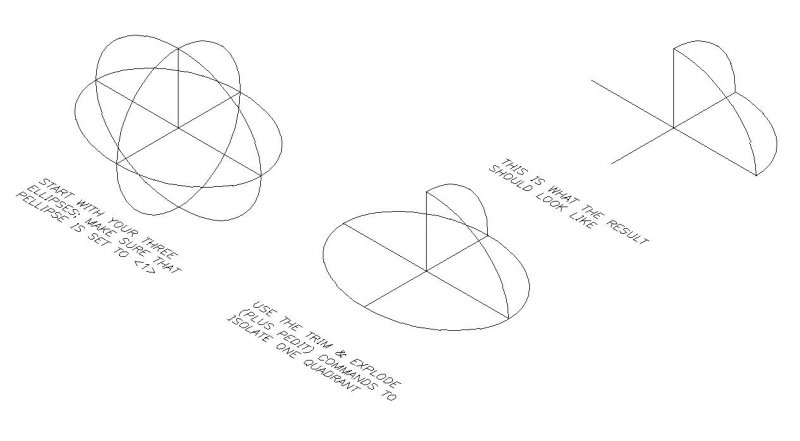

Loft from ellipse to Node is one method. You might need to add Guides or experiment with the Draft Angles and Magitudes.

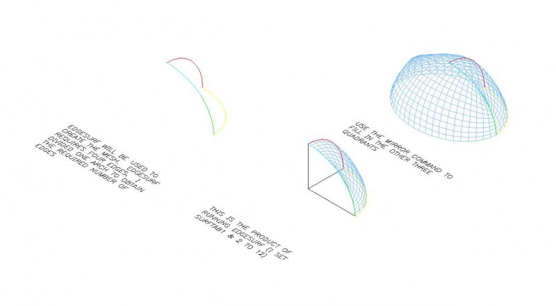

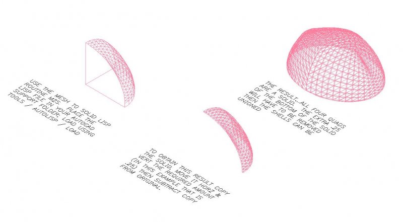

This is not as elegant a solution as posted by JDM but it does work. Originally created using AutoCAD 2004 and a lisp routine called M2S.lsp (mesh-to-lisp) when can be found and downloaded free off the Internet.
Edited by ReMark
Just so you don't have to go searching.
The file has to be renamed from the file extension of .txt to .lsp before you can load it. Use the Appload command in AutoCAD, find and select the file and AC will load it for you. To run the routine type M2S at the command line and follow the prompts.
m2s.txt

The method that you have proposed is very useful to visualize the structure of the dome.
With a mesh you could extract edges and sweep a shepe with along extracted paths for modeling complex structures.
