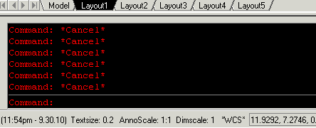

It seems that I am .lsp illiterate, but hey, I'm trying to learn.
Hopefully you can help me. I am looking for a piece of .lsp code that will allow me to go between layout tabs one at a time. The catch is that I need this to function like the keyboard stroke: Ctrl+Page Up or Ctrl+Page Down, where it simply jumps up/down one layout at a time, without needing to know the layout name.
Extra credit: To have this function start with the first layout tab and progresses through to the last layout tab (say, 20 layout tabs)
Does anyone know if this is possible?
I will be performing other tasks for each "current" layout as they are active, so I imagine that I would simply repeat a piece of code after I inject my code for each layout. Again... trying to teach myself how to do this.
Thanks in advance for your help.
