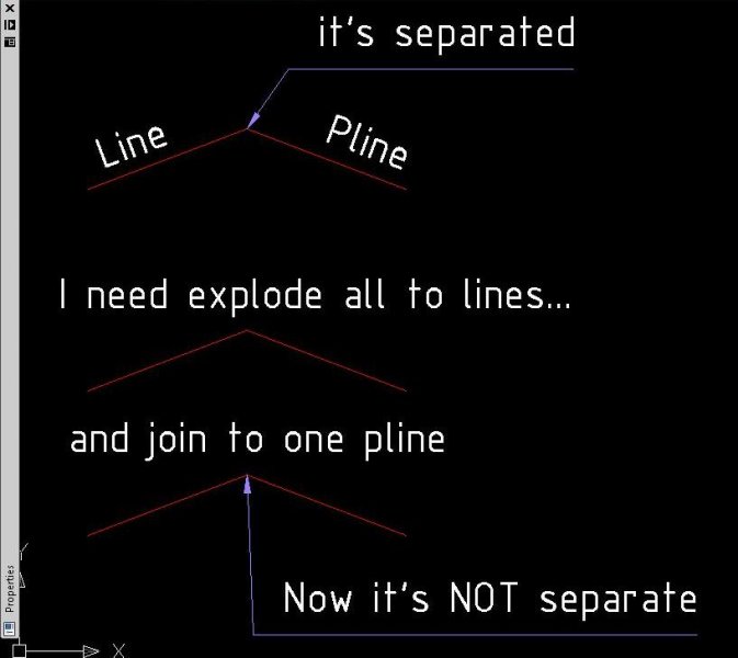

lutcus Posted September 30, 2010 Posted September 30, 2010 Hi, i found this lisp in this amazing forum:JOIN-LINES-J.LSP I need to complete this lisp, because this lisp does'nt join the line with pline and so I must to explode all plines to lines and after this i can to use this lisp, so i need to add this "explode" action in this lisp. PLEASE HELP! Quote

lutcus Posted September 30, 2010 Author Posted September 30, 2010 look at the pic.. i have line ant pline.. and I need to have one pline (wtihout using pedit cmd. it's too long to "play" for me)..i want to select all lines (lines and plines together. i dont care) type the lisp command and finish it. just two steps way to do it.. I added the lisp.. and this do this but just with lines..if i want to use added lisp (try it) i must have all lines.. so i must explode plines to lines and then i can to use this lisp ant join all lines to ONE pline..i thint it's more clear now.. and i'm sorry about my english Quote
ReMark Posted September 30, 2010 Posted September 30, 2010 I'm having monitor problems so the image you posted was unreadable to me. If what you are saying is true then I imagine that the original lisp routine used the "fillet" command to make the lines meet up before they were changed to plines and joined. Is that right? Quote

eldon Posted September 30, 2010 Posted September 30, 2010 In the picture, all you need to do is Fillet, then the line and the polyline will be joined as one polyline. Quote
