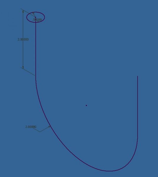

jdits7 Posted September 30, 2010 Posted September 30, 2010 Yes, on two different work planes, example, circle on the top plane, U shape on the front plane. Quote

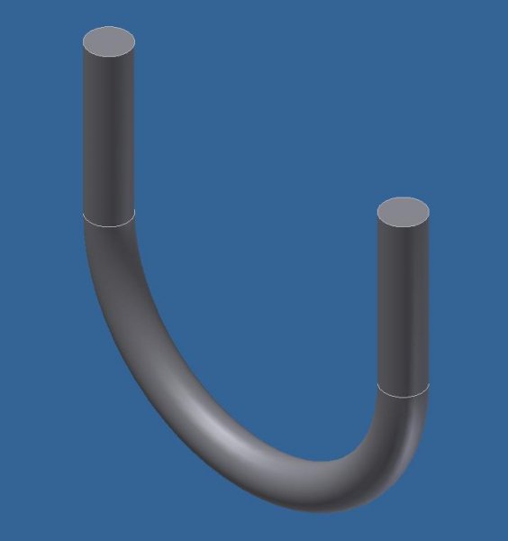

shift1313 Posted September 30, 2010 Posted September 30, 2010 Yes. If you draw the Hose profile on one plane, then draw the U shape on a plane that is 90degrees off(using the standard planes, dont create a new one if you dont have to). Make sure the U sketch is coincident with the center of your circle and use Sweep. What version of inventor are you using? Ive attached an example(not 29" long). IVSweep.zip Quote
abishop Posted September 30, 2010 Author Posted September 30, 2010 how do you coincident something on 2 diff planes? The cirlce to the path line? Quote
abishop Posted September 30, 2010 Author Posted September 30, 2010 never mind, i always forget to project. I will let you know when i have it......... Quote
Steve_wright Posted September 30, 2010 Posted September 30, 2010 Abishop here's a step by step tuturial of how i would do it . new sketch draw your desired shape from the center dot, (finish sketch) click work plane , then in origin click yz plane ..then move your curser over any end of the curve and click...then click new sketch on that plane. if you cant pick up the end point then project geomtry ..then draw your circle and diamention it. once you done that click finish sketch go to sweep...... profile the circle....... and use the shape as your path i think it should do it automatically anyway thats how i would do it..bare in mind i really am learning myself Steve:unsure:...lol unsure icon..(.but it did work for me .) Quote

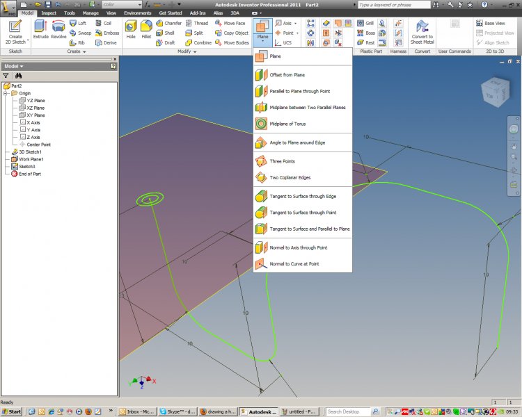

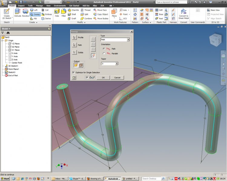

Hopinc Posted October 1, 2010 Posted October 1, 2010 (edited) Abishop, you have not indicated which version of Inventor you are using, so I am hoping that it is 2011? This latest version of the software has an improved menu giving better access to drawing planes. See picture 1 - here I have created a 3D sketch and used the "Normal to axis through point" command to generate a plane perpendicular to one of the pipe axes so I can create a profile to sweep. It's quick and simple. Edited October 1, 2010 by Hopinc Quote
