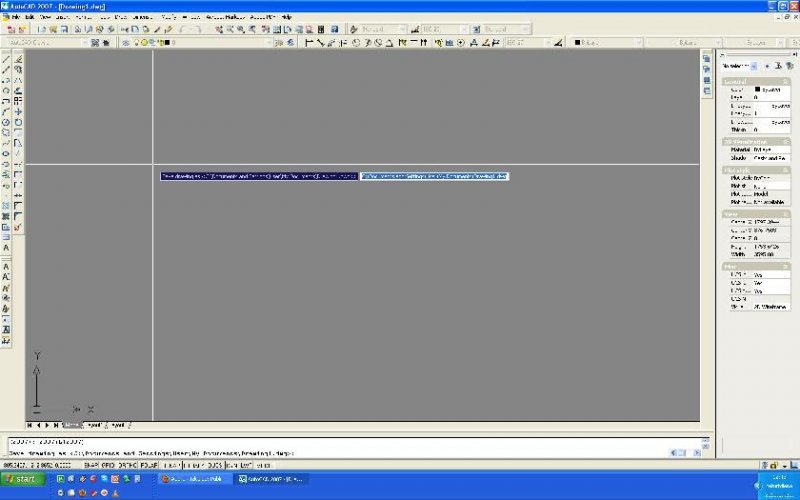

Can someone please tell me how to get back to normal save mode with an save window where can i choose the folders whith in I like to save. My current save mode screen is in attach, it switched not in my order.

didnt work, shows unknown comand :((( (AutoCad 2007)
Try FILEDIA=1.
I guess I should have been more clear. Type the word FILEDIA. Press Enter. If the value is shown as "0" then change it to "1".
I just tested this on my copy of 2007 and it works just fine.
Try again.

thanx comrads! works just fine!!!!!!!!
