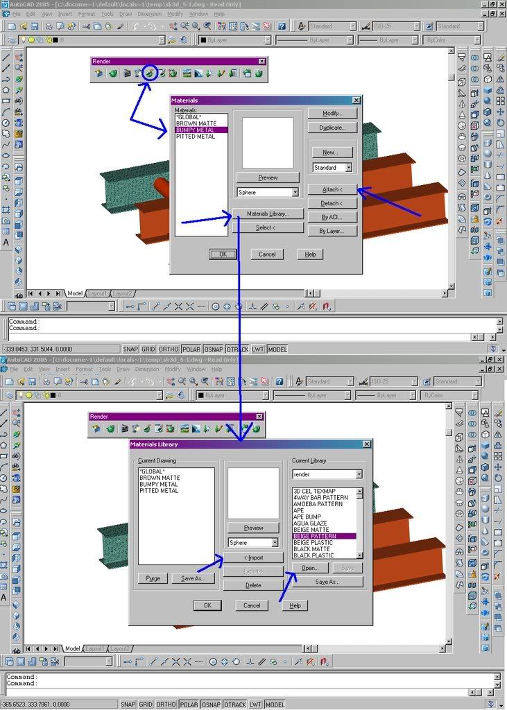

Oxygen454 Posted September 14, 2008 Posted September 14, 2008 I have steel beams and pipes, is there a way to add a texture to make the metal look metal? I found a website which has these textures but they do not tell me how to load and use them. Quote
shift1313 Posted September 14, 2008 Posted September 14, 2008 here is a screen shot i just took for you. From the render toolbar you hit the materials button and the window(similar to this one) will show up. The way it works is you need to have materials you want to use imported into the "current" space. If you click the Materials Library button it will take you to the second screen shot. You can see the headings are current library and current drawing. In the current library is any preloaded materials. You can select any of those and hit the preview button and it will show you a small sample, or you can click the open button and just navigate your hard drive to the location of your downloaded materials and open that folder. Once you have your materials in the Current Library area you need to select one, hit the import button and make sure it goes into your Current Drawing area. Once in your Current drawing area you can hit OK and it will go back to the materials window. From here you can attach material to your objects, modify material properties etc. With the material selected press the Attach button and select your i beam or i beams and hit enter. If you wish to modify it the top right corner of this window has a modify button which will give you options like bump map, roughness, reflectiveness i think. Each version of Acad things change a little, 07+ changed a good bit but i believe 04 should be the same as what i put here. Keep in mind this does not account for lights or an environment. I cant even begin to pretend i know what im doing with rendering because i never really play around with it so finding a tutorial on this site may be the best way for you to get familiar with it. Quote

Oxygen454 Posted September 14, 2008 Author Posted September 14, 2008 The materials screen is exactally the same. I loaded the materials in the materials library, then went into the materials screen (clicked on the round ball with the paint brush) and went attach, selected the beam, and hit enter. Nothing happened. I even tried different textures and nothing... Select objects: Updating drawing...done. Gathering objects...1 found Select objects to attach "BUMPY METAL" to: Updating drawing...done. The other thing is, all the textures on the web are .jpg when I need .mli Quote
Cad64 Posted September 14, 2008 Posted September 14, 2008 If I remember correctly, in 2004, those standard Autocad materials only show up when rendered? I could be wrong though, I haven't used those older versions in quite awhile. The .mli file is the Autocad Material Library file. It's a collection of procedural materials all bundled up into one file. You can still apply .jpg's as materials. Quote
shift1313 Posted September 15, 2008 Posted September 15, 2008 yes after you apply the materials you need to render(green teapot button). the render screen will ask you where you want to render to as well as prompt you for some additional level of controls on things like background. If you render viewport(i think) that will just render the screen your looking at, like in my screen shot you can see one beam is funny looking because i rendered the viewport. it will stay this way until you pan, zoom or change your viewports. Quote
Oxygen454 Posted October 19, 2008 Author Posted October 19, 2008 The 3D rendering finally worked but as soon as I move the screen (different views or zooms) the rendering disappears.... whats happening? lol Quote
Cad64 Posted October 19, 2008 Posted October 19, 2008 That's what I meant when I said that materials only show up when rendered in the older versions. Once you Zoom or Pan they disappear. There is nothing wrong, that's just the way the old versions work. Quote
