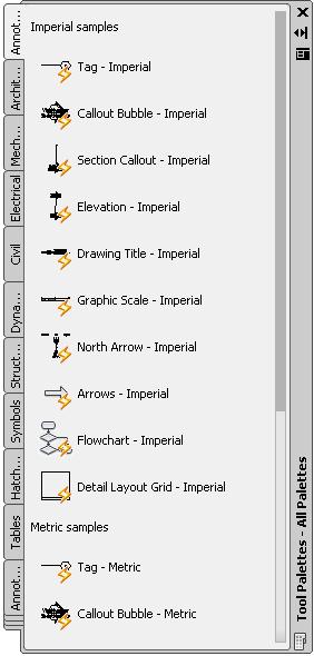

Andre Posted September 27, 2010 Posted September 27, 2010 hi, can you tell me how to put the leaders on with the dot instead of arrow head and the circle with number inside instead of just the line with text cheers Andy Quote
ReMark Posted September 27, 2010 Posted September 27, 2010 The line with a circle at one end with a number inside of it is called a Tag and can be dragged and dropped from the Annotation tool palette. There is an Imperial and Metric version so be careful to choose the correct one. Another option if you want a leader with a circle is to drag and drop the block called Leader - Circle from the Leaders tool palette and when prompted, at the command line, type in your Tagnumber. Quote
Andre Posted September 27, 2010 Author Posted September 27, 2010 i cant seem to find anything that i can drag and drop from the anotation palette can you screen capture or explain better for my stupid brain to work out. multi leaders kind off look like what i want but cant figure out how to work those either !!??!!?? thanks Quote
ReMark Posted September 27, 2010 Posted September 27, 2010 I'm guessing you do not have All Palettes opened as the default right? Quote
ReMark Posted September 27, 2010 Posted September 27, 2010 Where it says Tool Palettes in black lettering on a gray background...right-click. On the flyout window look for one of two entries - either select Annotation and Design or All Palettes. I prefer the latter. It's your choice. Do you have the Leaders palette visible? Quote
nestly Posted September 27, 2010 Posted September 27, 2010 If you're not familiar with the Tool Palettes, it's probably because they're turned off. CTRL +3 will toggle it on and off. The default Tool Palette tags are both Annotative and Dynamic, so again, unless you're already familiar with those type of objects, you may find it easier to just create a new multileader style that uses a callout or circle block. see attachments Quote

Andre Posted September 27, 2010 Author Posted September 27, 2010 ok i have created my newly styled leader and set as current. i might be going wrong somewhere, i am typing dim (return) L (return) then when i select the position of the leader and hit (return) it gives me the normal leader with the arrow ?? what am i doing wrong ? Quote
ReMark Posted September 27, 2010 Posted September 27, 2010 "what am i doing wrong ?" Briefly speaking...you aren't following our instructions. Refer to previous posts re: Tool Palettes. Besides that why are you even typing in the first place? Use your Ribbon, click on the Annotate tab, and use the commands found on either the Dimensions and/or Leaders panels. Quote
nestly Posted September 27, 2010 Posted September 27, 2010 Shouldn't each person be permitted to place annotations according to their own preferences? Some may find it preferable to create a new multileader style and place leaders that way. While tool palettes may be a great alternative, it's ultimately up to the individual. Andre, If you created a multileader style, then you'll need to use the MLEADER (or MLD) command rather than the Dim -> L command. After you place the leader, you'll be prompted at the command line for the text to place inside the circle. But try the palette method too, you may find you like it better. Quote
