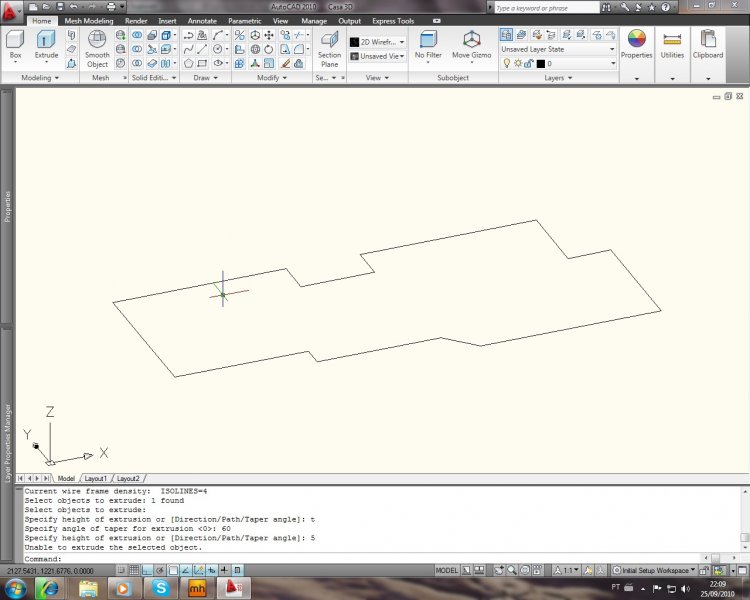

I want to use the extrude, givin it a taper angle of 60 and a height of 5, just to make sure that the extrusion will close, it was suppose to make a roof like shape.
Well, it was suppose to work, it always worked before.
Now it just don't want to extrude anymore, when I try a message "Unable to extrude the selected object" appears.
I'm getting mad with it because it has no sense, i alread tried to create another shapes but it didn't work.
If someone knows how to fix it, tell me, i need to do it.
Thank you
Post the drawing and we'll take a look at it. Without the drawing we will just be guessing. That will frustrate you and it won't make us happy either.
this is the image of the shape that i cant use tape angle
