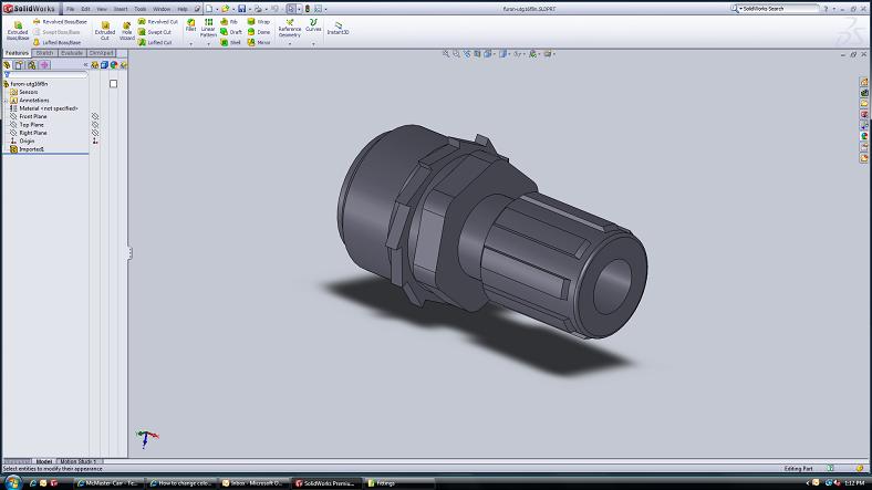

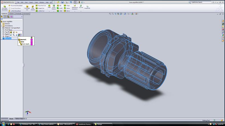

EvanH Posted September 23, 2010 Author Posted September 23, 2010 shift -- Thank you very much for the reply. This is exactly the problem though, I cannot get the color to change by doing that. Here's a screenshot (part is now resaved as .sldprt) ... I changed all the boxes in that appearances drop down box to magenta, but the part remains grey. It looks like the problem is, when I click on "Imported1" in the feature manager, the edges of the part become highlighted. For any other part, when I do that, the surfaces become highlighted and the color change works. Quote

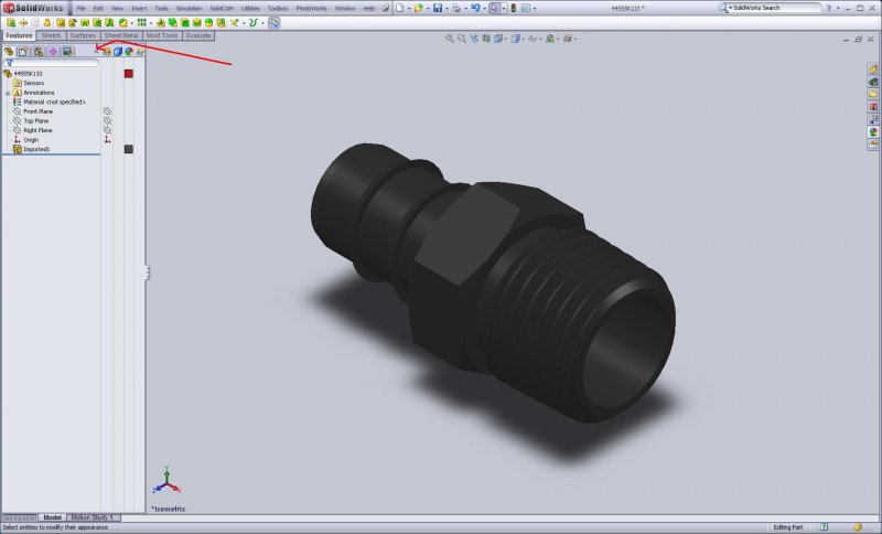

shift1313 Posted September 23, 2010 Posted September 23, 2010 Evan, expand the Feature Tree using the arrows i pointed to in the screen shot. Notice that the Appearance column has a color next to the part name and next to the imported body. The one on the imported body over-rules the one on the part name. I dont think this is the problem but double check it just in case. Quote
EvanH Posted September 23, 2010 Author Posted September 23, 2010 Evan,Can you attach part file? I can give it try for you.......maybe a video card glitch. Sure.... they are attached at the bottom, one as-downloaded and one saved as sldprt. Evan, expand the Feature Tree using the arrows i pointed to in the screen shot. Notice that the Appearance column has a color next to the part name and next to the imported body. The one on the imported body over-rules the one on the part name. I dont think this is the problem but double check it just in case. No color box next to Imported1 on the expanded feature tree: I can change the color of one face at a time, no problem. By clicking on this square, for example, and then selecting a new color: fittings.zip Quote

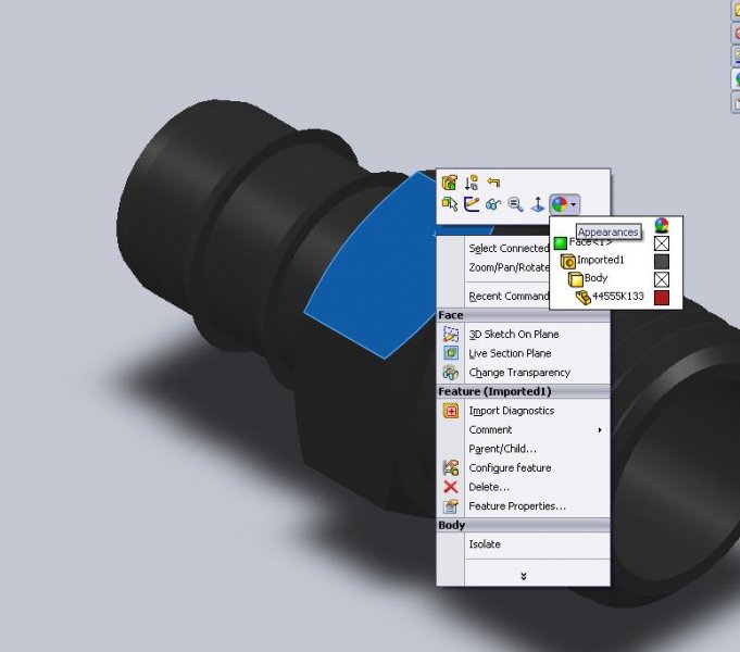

shift1313 Posted September 23, 2010 Posted September 23, 2010 That was a bit odd on this piece but there is an appearance applied to the entire part that you need to remove. Start by opening the part file. select a face then click the appearance ball and select the face appearance box(pointed to on the image above). When the appearance properties tab pops up select Remove Appearance. This will remove the appearance from that face. Then you will notice the button says Remove All Appearances. Click that and it will "wipe" it clean. After I did that it appeared to be a brass color. but from there you should be able to apply a single color to the part. If that didnt make sense i will try to take some screen shots for you. Quote
bhamze Posted September 23, 2010 Posted September 23, 2010 Evan, Follow Matt's instruction. I downloaded file and was able to change color of part. I too needed to remove all parts appearance for it to work. Quote
EvanH Posted September 23, 2010 Author Posted September 23, 2010 Thanks for your patience, guys. Matt, I think I follow what you said. But when I do that, only the face I originally selected changes color, even after I've done the "Remove All Appearances". Here's a vid of what I tried: Quote
