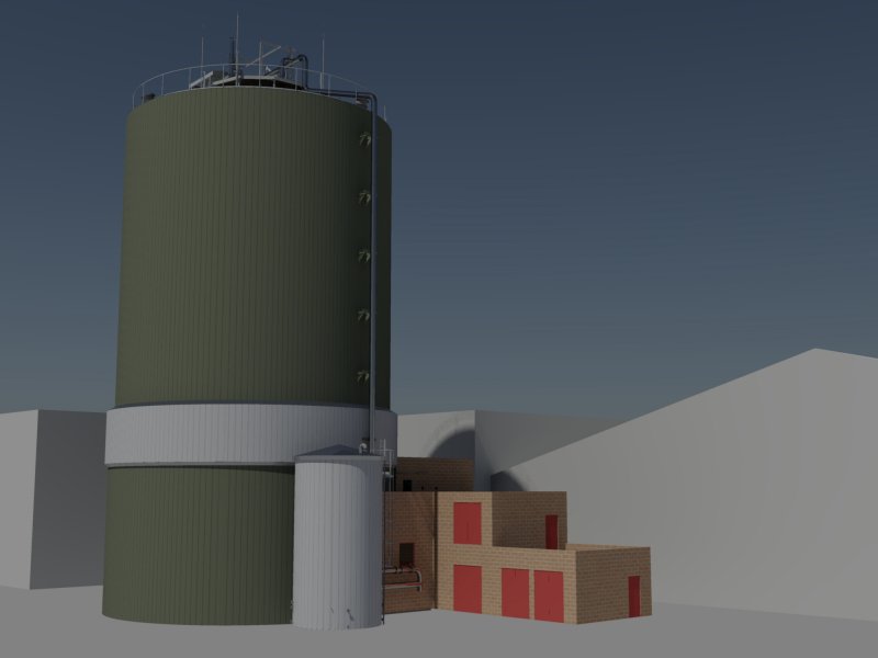

sky always looks like it's night, I want a clear sunny sky
no matter what day, time I set, this is the best I can get it...
what could be wrong ?

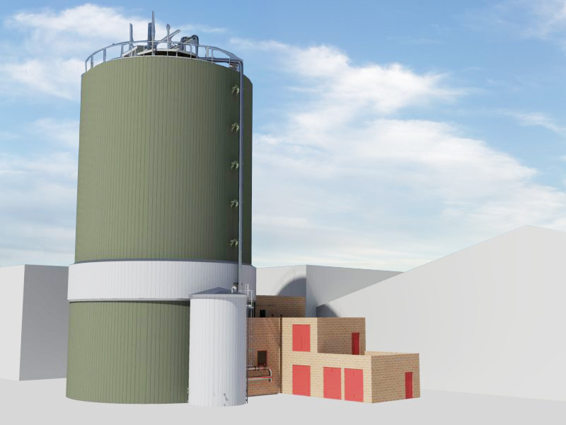

hello there friend, if your want your background to a clear sky, you need to work on it in Photoshop, crop the blue sky erase it and place your sky image, if you have Photoshop tell me so I can tell you the step by step process, I had some spare time so this is what came up after editing using photoshop.

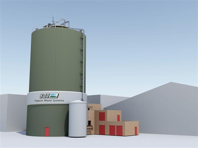

Hi all,
Photoshop (Gimp) is what I use for it now, but selecting around the roof of this silo is so difficult :(...

@arjun: thanks for this great photoshopwork, it looks great this way.

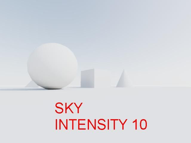

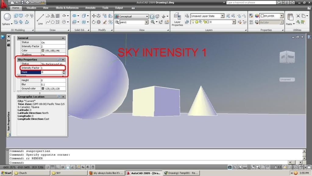

About the sky being to dark (like it's ganna rain) try to jack up the sky intensity until you get your desire sky illumination.
I hope I was able to help you...
About the sky settings here are some screen shots
sky intensity 1

sky intensity 10
the result you'll get
hope this helps and good luck (happy rendering :D)
I am gonna try a little more with that sky intensity. I can add contrast later. Thanks alot for your help, and hopefully there will be sunny skies above "AutoCAD 2012 renderland".
