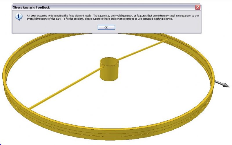

Lor Posted September 20, 2010 Posted September 20, 2010 (edited) Hi to All I'm new to Inventor and to this helpfull forum:) In these days i designed an spoked wheel (iron made), because i want to know what is its max stress and safety factor. But i don't know why each time i run FEA, there is an error that stop the analysis... Some one can help me? I'm using Inventor 2008 (i know...is old..) Edited September 20, 2010 by Lor Quote
rdharvey Posted September 20, 2010 Posted September 20, 2010 the error is telling you what your problem is... either your dimensions are invalid or there are features that are too small to compute compared to the rest of the geometry. find out what they are and just suppress them in your model.. is there hanging geometry because the part doesnt look overly complex and it should be able to mesh it easy enough. Quote

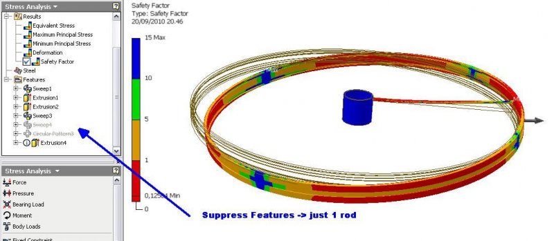

Lor Posted September 20, 2010 Author Posted September 20, 2010 There aren't small features. The FEA work only when i supress circular pattern and mirror...and seems there isn't small angled part outside the solid. To design all the rods i deleted some features but i don't think that this influences the FEA...or not? Quote

shift1313 Posted September 20, 2010 Posted September 20, 2010 These errors happen when you are trying to mesh a part with possibly some small fillets or really small features. You will need to simplify the model. For instance the "bead" area on your rim has a very small sunken area that looks to have small fillets. If you made your "rim" flat the analysis would probably look the same as what you have there, only it would not cause any issues. And so you know the output you get from FEA is only as good as your input. If you setup your conditions or loads wrong, the output you get will not tell you anything. I can tell you right now looking at your load arrow the output will probably not be very useful. What kind of condition are you trying to simulate? a braking force? Wheel hitting a pot hole? Side loading? What kind of loads are you working with and what are your fixed conditions? Quote
Lor Posted September 20, 2010 Author Posted September 20, 2010 (edited) New final version (correct but still doesn't run FEA) PullyOk.zip P.S. I see now your message, shift1313, i'll try to do so! My force is apllied to all the external surface, and simulate a tension of a steel rope around the whell. The problem isn't this beacause if i delete all rods less one, the FEA runs ok... Edited September 20, 2010 by Lor Quote
shift1313 Posted September 20, 2010 Posted September 20, 2010 It could be the fact that the rod is so much smaller than the other solids in the model. You may need to do some mesh adjustments to make some fine mesh in the intersection between the spokes and the rim. I cant open your file up here because i dont have IV08 or newer at work so hopefully someone else can shed some light on it. Quote

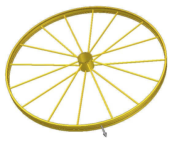

shift1313 Posted September 21, 2010 Posted September 21, 2010 Lor, i have inventor 07 at work, ill try to reproduce the rim when i get a chance to see if i get errors with the spokes. How many spokes are on the rim? Also in a real spoked rim the spokes are attached with nipples that will allow the spokes to bend and deflect. having them rigid in your model wont produce the same results as with them "floating" to a certain extent. Quote
Lor Posted September 21, 2010 Author Posted September 21, 2010 There are 16 rods inclined...model is complex. I didn't want to invent any stuff! This is the reproduction of my real whell in my garage, that i want to test. Quote

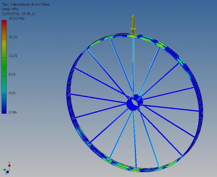

Lor Posted September 21, 2010 Author Posted September 21, 2010 As i suppose the problem is Inventor 2008..... The same whell (same part file!!!!) open with Inventor 2011 gives all ok: That's all folks. Thanks to all :-) Quote
shift1313 Posted September 21, 2010 Posted September 21, 2010 Works fine in inventor 11(2007) I drew this one so i suppose its an issue with the model and not actually performing the operation. I just went off the picture and no dimensions. The hub here is 3" diameter and the overall wheel was 36" i think. If i get time i will open your file tonight and see if i can find a problem. Is it possible there is a small gap between the end of your spoke and the rim? If you used a sweep and your sweep path didnt start and end inside the solid body of the rim or hub this could be your problem. Mine was created by extruding and using the To Next option for the end condtion to ensure a proper fit between spoke and rim. Quote
