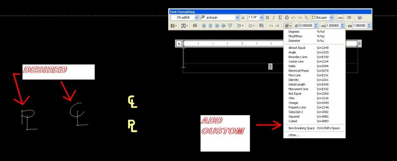

qball Posted September 17, 2010 Posted September 17, 2010 I read over some of the previous threads and couldn't find exactly what I'm looking for. I want to put the Centreline and Plate (aka Propertyline) symbols in my text. But preferrably it will match my text style (which is archquik. shx ?). I could turn it into a block to insert into Mtext, or textexplode and do the same if necessary. I read http://www.cadforum.cz/cadforum_en/how-to-add-own-symbols-to-mtext-symbol-list-tip6880 and http://blog.jtbworld.com/2007/11/add-personal-mtext-symbols-or-text.html JTB's puts the new symbol right in the pull-down menu, but I believe his custom symbols are just text, and not a block. Is there a way to do what I want? Quote

qball Posted September 17, 2010 Author Posted September 17, 2010 As long as the block is embedded in the MText, I'm good with that. Maybe a quick code or insertion method would help too. Quote

BlackBox Posted September 17, 2010 Posted September 17, 2010 (edited) As long as the block is embedded in the MText, I'm good with that. No... I believe ReMark meant you might use a block, which already has this text style formatted. You cannot 'embed a block within MText'... whereas you can 'embed the MText within the block'... Make sense? Edited September 17, 2010 by BlackBox Clarity Quote
qball Posted September 17, 2010 Author Posted September 17, 2010 no the block wouldn't work. Too many variables to the surrounding text. Quote
BlackBox Posted September 17, 2010 Posted September 17, 2010 Well Qball, If the registry route doesnt work, and the block isn't going to work, I just not sure what to say. Good luck! Quote
qball Posted September 17, 2010 Author Posted September 17, 2010 I don't want to mess with the registry. If I find something I'll post up. Quote
monk Posted September 19, 2010 Posted September 19, 2010 Can you not create your own font, and then create your own symbol within. Very much like the windings fonts. you can then insert it?Not as difficult as it sounds Quote
