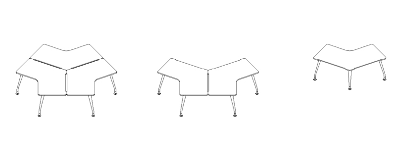

busseynova Posted September 16, 2010 Author Posted September 16, 2010 I've done them in 3D. The reason for Iso is that on our website we have the other products as line drawings, processed through illustrator. This also means we have them as EPS linedrawings in the event that there are no other images of a product. I've started on the isometric route as I now need to do the section for this range and it would be nice to have it looking consistent between the ranges, but as you can see from this previous section: http://www.verco.co.uk/systdesking_visbeam.htm my predecessor clearly struggled with the 120 too! Quote

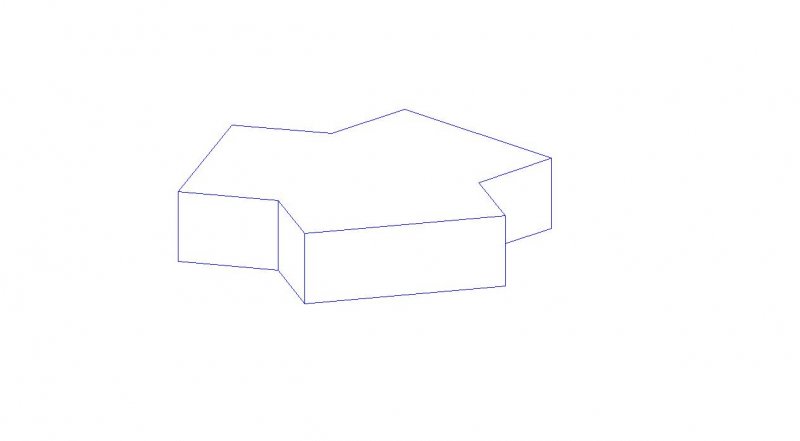

ReMark Posted September 16, 2010 Posted September 16, 2010 Down and dirty. 2D block created from a 3D triple-desk via the Flatshot command. Quote
