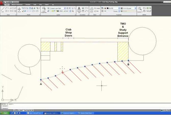

Drawing an Angled Line
There are a couple of options. One is Polar-Tracking and the other is direct distance entry. DDE input requires the length of the line and the angle. Ex. - 20
Did we mean @20
Using your points, and adding one. Hey, what would I know?

Thanks Tankman - I will have a go at that.
The bays will be on the other side towards the shop itself so I will use the same principle methinks!
