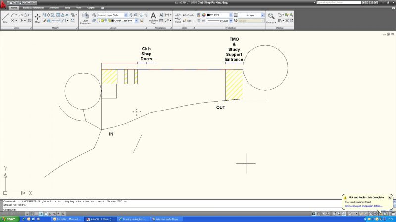

ChrisGrady Posted September 13, 2010 Posted September 13, 2010 Hi All - Please excuse my naivety I have only just started using Autocad and have only had some very basic training!! I am trying to design a car park for our club shop and there is an arc which I need to put some spaces at a 45 degree angle and as the polyline is not horizontal or vertical I cannot get the angle right - can it be done when the original line is at an angle? I hope that this makes sense!!! Chris Quote

ReMark Posted September 13, 2010 Posted September 13, 2010 Nice graphic but you do not indicate what line your new line is being drawn from. I think that info might be helpful don't you? Is the new line going to be perpendicular to this polyline? Hmmm....are you putting these parking spaces along that line between the words "in" and "out"? Is that line curved or is it constructed from a series of straight segments? Quote

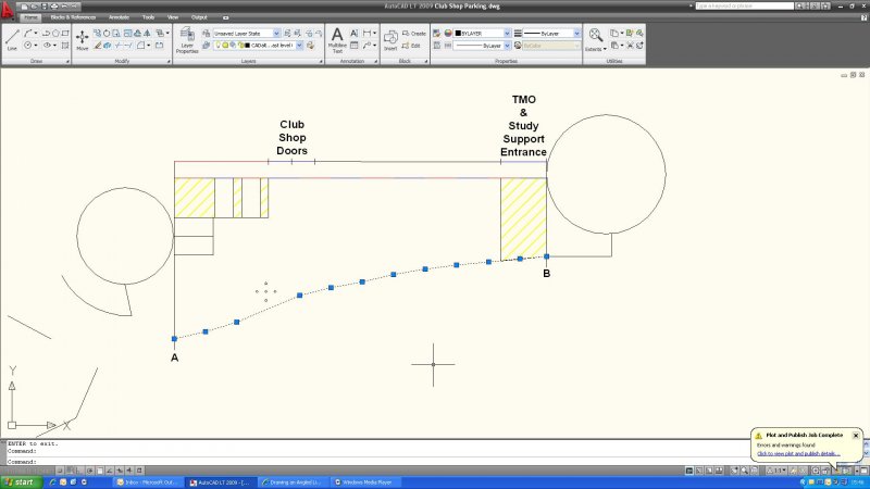

ChrisGrady Posted September 13, 2010 Author Posted September 13, 2010 Too true!! oops - sorry!! Is this better? it's between point A and B (obviously!!) Quote
ChrisGrady Posted September 13, 2010 Author Posted September 13, 2010 You are correct I will be putting the spaces on the line that I have highlighted - I took measurements every 4 metres from the horizontal line below the club shop doors and plotted the measurements in a vertical line then I joined the lines by using a polyline hence the angled line (the line actually represents bollards) Quote
lpseifert Posted September 13, 2010 Posted September 13, 2010 Try making a block of your parking stripe (at 45 degrees; maybe 135, 225 or 315 depending on the direction that the polyline was drawn) and use the Measure or Divide command Quote
ReMark Posted September 13, 2010 Posted September 13, 2010 Try making a block of your parking stripe (at 45 degrees; maybe 135, 225 or 315 depending on the direction that the polyline was drawn) and use the Measure or Divide command I might agree with this but it appears there are a number of line segments and the OP might not get the desired results. Could the OP reorient his UCS with each line segment then draw the new line at whatever angle he was going to use? What angle will be used? Quote
lpseifert Posted September 13, 2010 Posted September 13, 2010 I might agree with this but it appears there are a number of line segments and the OP might not get the desired results. Oh, I agree with that- garbage in garbage out. Seems to me it should be a curve (or a series of curves) Could the OP reorient his UCS with each line segment then draw the new line at whatever angle he was going to use? What angle will be used? Yep, he could do that... the angle would be dependent on the direction of traffic flow. I would probably use Polar Tracking set at 45 as suggested earlier. Quote

cadvision Posted September 14, 2010 Posted September 14, 2010 you can set your SNAPANG to 45 and just draw lines. Basic. REmeber to reset SNAPANG to 0 when you finish Quote
ReMark Posted September 14, 2010 Posted September 14, 2010 you can set your SNAPANG to 45 and just draw lines. Basic. REmeber to reset SNAPANG to 0 when you finish Sounds dubious at best since the "curb" in this case meanders along a curve comprised of line segments. Each line drawn would have to take into account the portion of the "curve" it is being connected to. Quote
cadvision Posted September 14, 2010 Posted September 14, 2010 ReMark. I was pointing out at a very basic level of drawing you can just change the SNAPANG and draw. I have used this for 20 year. It is a very quick ( & dirty, maybe) way. I have a PIKSNAP (little lisp code) command too, allowing you to set your SNAPANG to that of a line in your drawing. I'd have made a block with the parking spaces set for a "square" lot and insert it for best fit to the traffic flow and curbing - But then I am only an Electro/Mechanical draftsman, so what do I know of Civil works Quote
