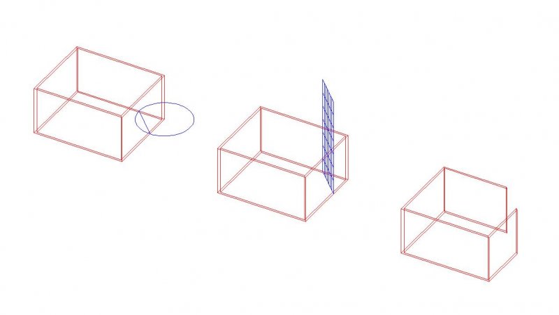

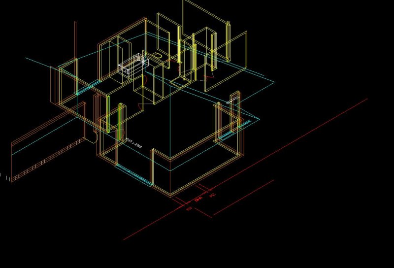

BIGAL Posted September 14, 2010 Posted September 14, 2010 You can use thickness to give the effect of wall heights then you just draw in the normal plan view. No need to trim as the object is not a solid you will tough need two lines to represent a wall. I am having problems pasting an image to here our IT guys have done something, a full 3D house done this way, then use pfaces's for the roof walls & doors can be cut in fly throughs are possible, walk up a spiral stair case in your new house it looks pretty cool. Sent you a private email pleas respond if you want an example, will try to sort out the image problem. Quote
BIGAL Posted September 15, 2010 Posted September 15, 2010 example attempt 2 Finally got it to work Quote
