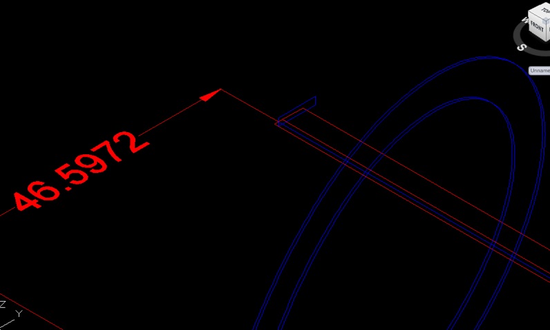

rohitjvbibin Posted November 15, 2010 Author Posted November 15, 2010 SEANT, My drawing is almost over. If u can get some time to help me out with this last section I will be grateful. I am sending you a section of my diagram. you have already seen this section. I have included the dimensions. Can u see if u can help me with sweeping that section over the length . The blue line is the line i have used for listing the top and bottom diameter. So please see if u can draw a sweeped solid. Please reply when time persists. Waiting for ur reply. RohitjvBibin Quote

rohitjvbibin Posted November 22, 2010 Author Posted November 22, 2010 Hi there Mr. SEANT, Thanks for ur previous file. It worked perfectly and I was successfull in exporting it into my meshing software GAMBIT by ANSYS. Please see if u have time for a small help too. Below is an attached file which you has modelled (using LOFT command i suppose). The only problem with it is it is not a 3d solid but consists of lines and regions. i am not able to export it as an ACIS (*.sat) file into GAMBIT. I tried sweeping it again but am not able to match upto ur perfection. Kindly see if you can convert it into a 3d solid or else please delete it and see if you can draw me a new one with the dimesions i have provided. The line I have measured the dimensions is a blue line marked in the figure. I have also included the new rectangular crossection for you which you can loft across. Please not that the sweeped object should stay in the area just like the previous one. It should not go above or below the area. The file is located here: http://www.sendspace.com/file/cnmg5d I would be grateful for ur help and reply. Eagerly in need of ur help RohitJVBibin Quote

SEANT Posted November 23, 2010 Posted November 23, 2010 rohitjvbibin said: . . . .if you can draw me a new one with the dimesions i have provided. The line I have measured the dimensions is a blue line marked in the figure. I have also included the new rectangular crossection for you which you can loft across. Please not that the sweeped object should stay in the area just like the previous one. It should not go above or below the area. . . . . The linked file is not entirely clear on what is the new Cross Section (Presumably the 6.0 x 1.2 rec) and the area in which it should be contained. The red lines do not seem capable of containing the helixed solid. Quote
rohitjvbibin Posted November 23, 2010 Author Posted November 23, 2010 Yes SEANT. I know that the section is out of the red line area and that is on purpose. I shall subtract it from the outer casing(not in figure) above the lines when i export it into the software GAMBIT. You can proceed with the same rectangular section when time persists. Thank you for responding. RohitJVBibin Quote
SEANT Posted November 23, 2010 Posted November 23, 2010 I'm curious: Why the need for a constant 20 Degree gradient? Acis file attached. LargerHelix.zipFetching info... Quote
