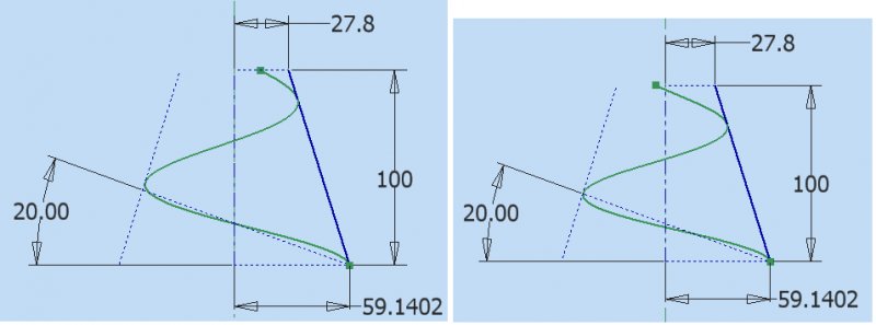

The exact dimensions are Base Radius: 59.1402mm; Top Radius: 27.8mm; and Length: 100mm....And the Helix Angle should be maintained constant at 20 degrees. I dont know how to find out the no of turns. or pitch. Thanks for ur instant reply Remark...
So at the end of one turn the helix will rise 21.5253mm right (assuming of course a 20 degree angle of rise). 100 divided by 21.5253 = 4.64569. My wild guesstimate.

I think maybe it could be done in AutoCAD (actually I'm pretty sure it can), but I'm also pretty sure I wouldn't even try. I used Autodesk Inventor. If I get a chance I'll model up entire part. Nice thing about a 3D program like Inventor - if I don't get it right on first try it is simple matter of editing parameters.
Students can download Inventor Professional for free from http://www.autodesk.com/edcommunity
It is an interesting problem. Here’s an Excel/AutoCAD way of dealing with the parameters.
Unfortunately, It appears that a tapered helix (i.e., larger radius at bottom than top) can not maintain a constant angle w.r.t. horizontal while also maintaining a constant pitch.
If that is an absolute requirement, I don’t think it can be done with the helix command.
A spline with the appropriate control point positions would be needed to model the geometry.

As is typical, I’ve pursued an idea beyond what is useful. . . .even to the OP. I do find the puzzles entertaining, though, so that preceding statement isn’t so bothersome. :)
The Excel spreadsheet and DWG from my post above have been modified to demo a tapered, helix like structure (Spline) that maintains a constant 20 degrees incline from a horizontal plane.
This new curve (Red) varies quite a bit form my original helix (White).

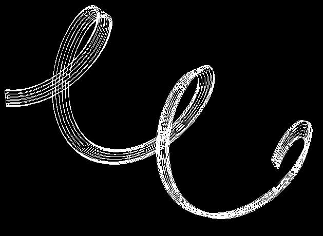

Even with a fairly clean spline, however, a sweep operation can be difficult. I’d recommend sweeping with a perpendicular cross section. In the attached I’ve just reoriented the rectangle but you may have to derive what the new perpendicular section would be if the orthogonal section should remain as you have shown.
Here is the command sequence for the sweep shown in the attached image:

The splines are continuous but now a new problem arises.
In the first convergent divergent part (103 mm), when i sweep the section it comes out fine but i noticed that when it reaches halfway it goes below the required place. I am not able to move it above because then the whole helix gets moved.
In the second almost straight part (284 mm), when i sweep the section it too comes out fine but the same way the middle part goes below the required place.
I am sending you my whole diagram with both sweeped helixes and the sections on them...
I have written important points in the drawing itself.
The section on the convergent divergent part is a rectangle of thickness 1mm and height given in the figure.
The section on the straight part is a rectangle of 1.2mm thick and height is given too....
Please note that the sections should not be perpendicular to the sweeped line but in the way i have drawn them in the diagram. The problem with this is that when i sweep them(with Alignment option NO) they remain the same on the starting part but get perpendicular on the other end.
please see if u can correct that too...
