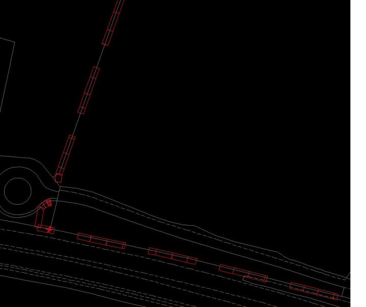

I have copied a closed PL from one drawing to another and it looks perfect on the first drawing but when I paste it in it's missing the centre solid bit. Anyone know why this is happening?
It's the red line in the attached image.
Thanks in advance.

You're missing the centre solid bit? Has FILL been turned OFF? I can't tell for sure because I can hardly see anything in the above image. Wait a bit while I turn up the brightness control on my monitor.

:) It's clear enough
FILL is ON. :(
If I insert the red line as a block and go into block editor it looks fine but when I come out it has the hollow bit.

I just tried to recreate what I hope have described by making an object using a polyline with an assigned width and turning it into a block. I then inserted the block and the polyline retained its width. Fill was verified as ON. I turned Fill OFF and the image on my screen remained unchanged until I did a Regen. Did you try a Regen?
