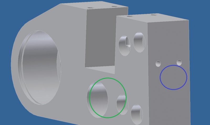

gargoyle27 Posted September 7, 2010 Posted September 7, 2010 i need to drill and thread a hole that is parallel to one face, but on a 30* angle with the other face, how do i do that? it goes from the blue circle, to the center of the larger hole at the green circle (its approximately 30* anyway), i have attached the file as well angled hole drilling problem.zip Quote

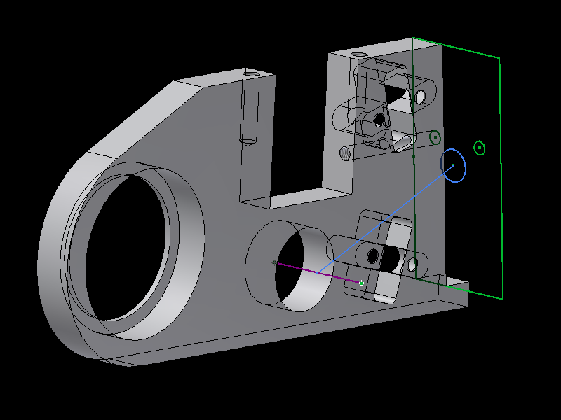

JD Mather Posted September 7, 2010 Posted September 7, 2010 (edited) Create workplane. Edited September 7, 2010 by JD Mather Quote
gargoyle27 Posted September 7, 2010 Author Posted September 7, 2010 for some reason i thought there might be an easier way, what if i don't know the actual angle but i know it goes through the center of that other hole, and where it starts? can i somehow use a work point to make a hole and just make it pass through the center of that other hole? Quote

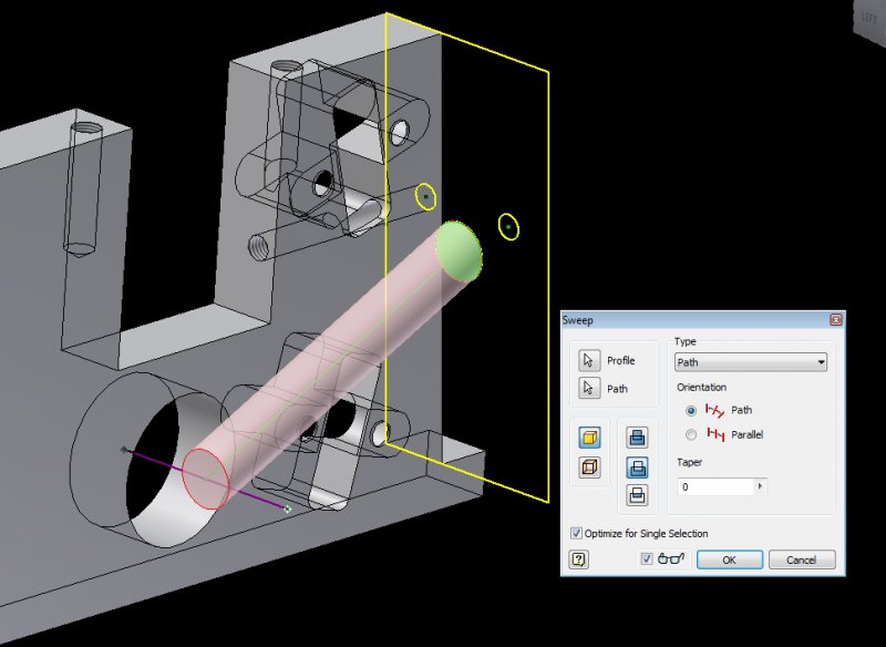

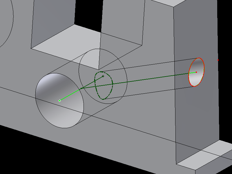

kencaz Posted September 8, 2010 Posted September 8, 2010 You can use a couple of work points and a 3d sketch. No need to know the angle. Then just do a sweep cut and thread. KC Quote

gargoyle27 Posted September 8, 2010 Author Posted September 8, 2010 kencaz, can you describe a little better how thats done? i haven't ever used 3d sketches or the sweep function Quote
JD Mather Posted September 8, 2010 Posted September 8, 2010 .... the center of the hole is 66mm from the top of the part and of course goes thru the center of that other hole, lets see what you come up with What are the thread specs? I assume this will be a pipe tap? Is the hole the same size all the way - or is it stepped down? KC example doesn't look cylindrical to me. Quote
gargoyle27 Posted September 8, 2010 Author Posted September 8, 2010 its a constant diameter, threaded M12x1.75 about 60 deep, counter bored with a diameter of 20 and 8.15 deep at the center it's just for a long bolt to lock the location of something in that hole that's its centered with, after talking with the head machinist it's location doesn't matter as long as it doesn't cross anthing else, so i just went with 25* i just did a revolution and added the thread after, not sure why i didn't think of that to begin with, guess i got a little overwhelmed with this complex part, the idw is fricken rediculous to look at Quote
JD Mather Posted September 8, 2010 Posted September 8, 2010 Well, I had already modeled at the location you specified - I let you change the hole parameters. (see attached) I would call this a pretty simple part compared to most I get involved with. Make sure the tap will fit in that slot with the M10 threads. i just did a revolution and added the thread after Make sure you used the tap drill diameter and not the thread diameter for the Revolve. PFM42_JD.zip Quote
kencaz Posted September 9, 2010 Posted September 9, 2010 What are the thread specs? I assume this will be a pipe tap? Is the hole the same size all the way - or is it stepped down? KC example doesn't look cylindrical to me. C'mon JD, How am I going to sweep a non-cylindrical hole? I think it's only the angle... Plus I sliced the part in half... Quote

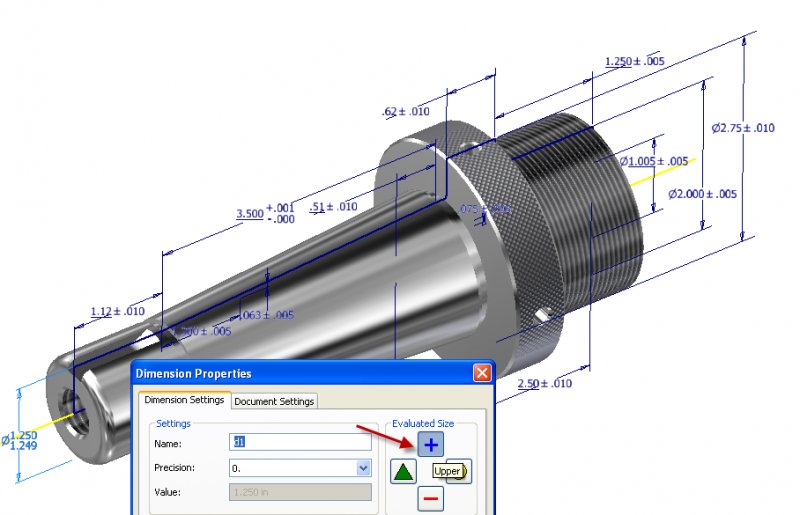

JD Mather Posted September 9, 2010 Posted September 9, 2010 Here is an interesting example of a machined part - not all that difficult, but notice that all of the dimensions have assigned tolerances. Tolerance stack-ups can be evaluted by setting the various dimensions at Min, Max, Nominal or Median. The model automatically updates when evaluated. Not many realize you can do this. In the real world nothing can be made to exact dimensions - there are always tolerances associated with each feature. This becomes important in assembly. Quote
gargoyle27 Posted September 9, 2010 Author Posted September 9, 2010 That's interesting, we only use tolerances for tighter stuff, and the head machinist just tells me what they are when i'm drawing it and i add it to the idw, didn't know you could dimension the original sketch with tolerances Quote

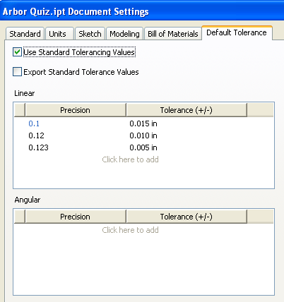

JD Mather Posted September 9, 2010 Posted September 9, 2010 ... didn't know you could dimension the original sketch with tolerances There are two different ways. For common ± tolerances based on number of decimal places you can set these up in advance in your template (see attached). For all close tolerance Deviation, Limits, Fits.... you can change the properties on individual sketch dimension or feature dimension properties. Quote
