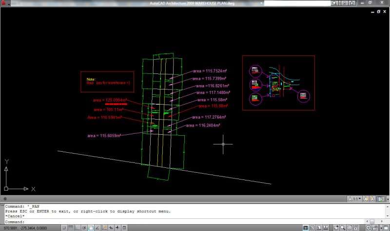

Autocad 2009 MENU- MISSING
hello there how will I fix this problem? :oops:
still not fixed.

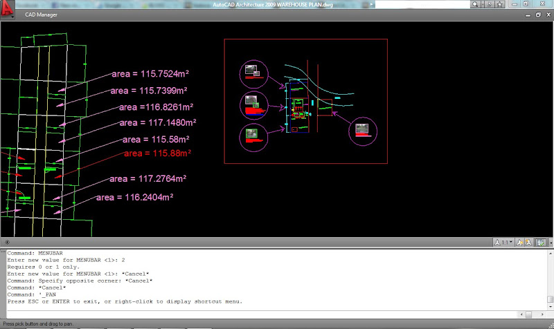

only CAD MANAGER appears. :(
Maybe your menus are not loaded. Try the MENULOAD command or the CUILOAD command.
Thanks! it worked but it looks like I have to load the menus one by one... :(
