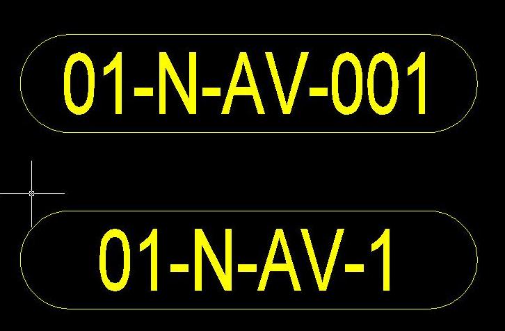

Hello All,
I am currently working on a block program for Cable ID Tags. The tags use a sequential number at the end. They start out at 001, 002, 003 & so on. When the program inserts each block the number is to increase by 1. The problem I am having is the leading zero's in the number do not show up after the block is inserted. I thought changing dimzin would work, But it did'nt happen.
See image below.
Is there a variable for this or do I need to use some sort of special method to achieve this?
Any help is much appreciated.
Thanks

(defun AT:NumFix (s n)
 ;; Fix number string with leading zeros
 ;; s - Number string to fix
 ;; n - Number of characters for final string
 ;; Alan J. Thompson, 10.29.09
 (if (< (strlen s) n)
   (AT:NumFix (strcat "0" s) n)
   s
(AT:NumFix "3" 4) -> "0003"

Correct. First is the number string and the second is the desired length of the string
eg. (AT:NumFix "1" 3) would yield "001".

Ok, So as the sequence increases, I would need to use a conditional statement. ex: 001-009 & 010-099 as these would change due to fewer leading zeros when the reach these points.
It will account for any string
(AT:NumFix "123" 3) -> "123"
(AT:NumFix "12" 3) -> "012"

Ok, I got my leading zeros now. Just a few odd quirky things going on that I will need to fix, But I am closer now than before.
Thanks Alan.
