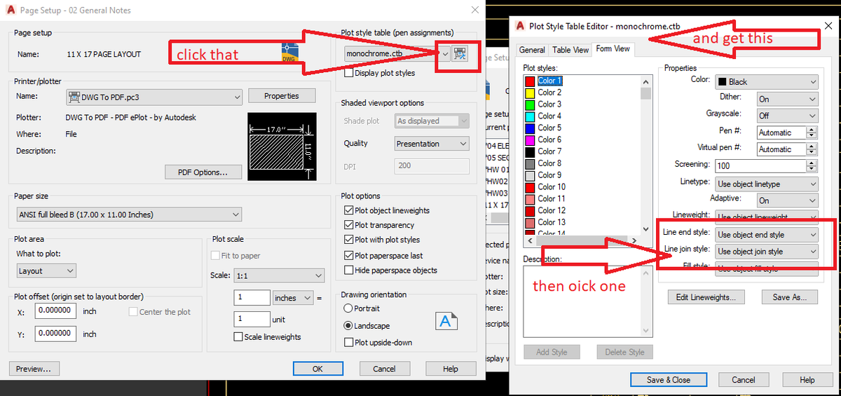

Well it is comforting to know that I am not the only one baffled by this mistirouse setting or variable.
But, I must thank everyone for helping me figure out my issue here at my office. The issue was fixed by turning the plot style pen table (line end style) to round.

There was a variable for this many years ago but I can not find it on ACAD 2021
apparently it is now connected with layers, but still have not found the variable

this is one way.

I used the PLINEGEN variable set to 0. That did the trick for new plines. Previous generated plines should be "properties matched"
