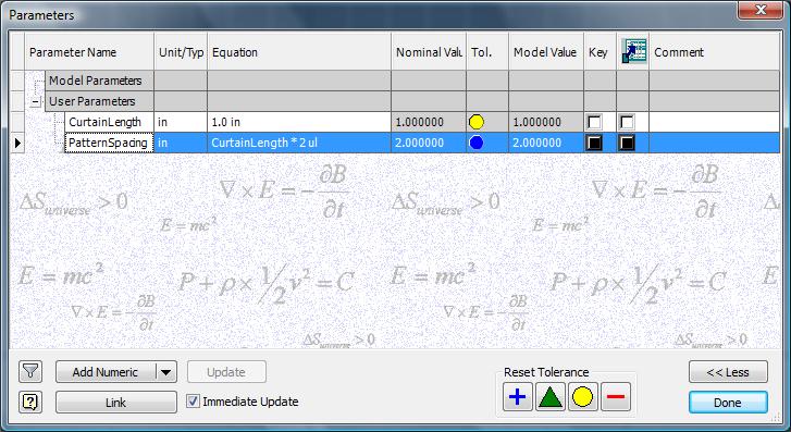

Well one way to do this is through parameters. What is your background with inventor. Are you familiar with parameters and animating parameters in Inventor Studio?
In order to do this through parameters(not the only way) you need to be real careful with your first sketch. I just threw this real crude example together. Hopefully you can open it and take a look.
Basically I drew one section of the curtain and used some parameters I created for some dimensions. I created a parameter that was the width of the sketch * 2 which was used for the distance of my rectangular array.
In inventor studio I made my curtain dimension parameter a 'favorite' and animated it from 1" to 1/2" then back to 1" over 4 seconds.

Your best bet for parameters is the Inventor Help. Basically any time you add a dimension to a sketch inventor creates a parameter. These are labeled things like d0, d1 and so on. You can name them whatever you want within reason(no spaces). You can add parameters of your own before, during or after sketches and operations and you can edit them from the parameter list. You can use these for your dimensions by either typing in the name or using the drop down arrow next to the dimension and List Parameters.
To get to the parameters you go to the Manage tab on the Ribbon bar.
At the bottom of the parameters window you will see "Add Numeric". You can then type the name of your parameter and its value. You can see here two that Ive added before modeling anything.

How about this. Inventor is a parametric cad software. This means the model is defined and controlled by parameters. When you draw your first sketch, you need to locate your sketch with constraints and dimensions. These dimensions are all parameters that define your sketch. If you open up an old drawing, go to the manage tab and select Parameters it will bring up a list of every dimension you have added. In order for you to animate using parameters you need to manually add them just as i did above in the screen shot. There are two sections(in my screen shot). One for Model Parameters and one for User Parameters. The user parameters are the ones you add and name. Model Parameters are the ones added when you simply dimension something. For instance if you draw a circle in your first sketch and give it a diameter of 50. In the model parameters part a dimensions d0 will show up with 50 as its nominal value. This parameters window is just a running list of all the parameters in the model.
