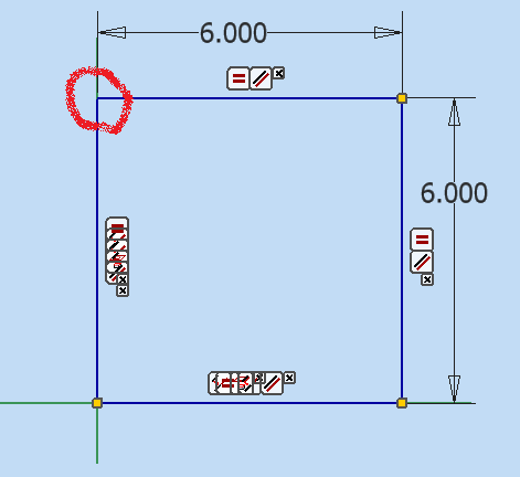

momentumbob Posted August 31, 2010 Author Posted August 31, 2010 (edited) Test box.zipO.K. This is my little test file where I just imported a box. Sorry for the delay, but work keeps intruding. If it turns out to be a no brainer solution and I still can't get the larger files to work I'll forward one of them. Thanks Bob Edited August 31, 2010 by momentumbob Quote
JD Mather Posted August 31, 2010 Posted August 31, 2010 Missing coincident constraint upper left corner. Attach the original dwg here. Quote
momentumbob Posted September 1, 2010 Author Posted September 1, 2010 Thanks for your help. Simpleton that I am, I understood that when the sketch line changed colour it was an indication that it was fully constrained. The profile that I am trying to extrude requires over 1600 dimensions when I automatically dimension it in sketch mode. Will I have to examine every single sketch element for proper constraint to ensure that it is recognized as a closed entity in order to extrude it ? Quote
