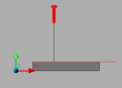

alijahed Posted September 11, 2008 Author Posted September 11, 2008 JBullseye74 said: Version of Autocad? 2008 you can just hover your cursor over the surface holding down your ctrl key then push/pull the surface to the desired location. thanks for the replies, I don't want the solid extended to the line I want the line extended to the solid surface. let me explain my problem, actually I solved it with other simple tricks but I always looking for something smart and easy that's why asking. I have a exploded drawing there is a screw far from a surface. With drawing a line I want to show where the screw is going to touch the surface. Already there is a small guide line in front of the screw so if there was an extend command in this situation I could extend that line to that surface. Cheers Ali Quote

alijahed Posted September 12, 2008 Author Posted September 12, 2008 shift1313 said: so you are just making an exploded view and needed a reference line? yes, see the attached file. Drawing2.dwgFetching info... Quote
eldon Posted September 12, 2008 Posted September 12, 2008 One quick and easy way is to take a front view, draw a line along the top edge of the solid, then EXTEND works. Erase the temporary line, and job done. Quote
alijahed Posted September 14, 2008 Author Posted September 14, 2008 eldon said: One quick and easy way is to take a front view, draw a line along the top edge of the solid, then EXTEND works. Erase the temporary line, and job done. That was cool, so somehow in 2D views of 3Ds we've got Extend command! Cheers Quote
