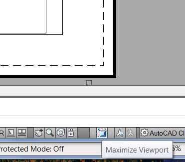

MIgo, Turn on the drawing status bar at the bottom of the screen. Select the viewport minimize button. VP max.JPG
I have just tried this out.
