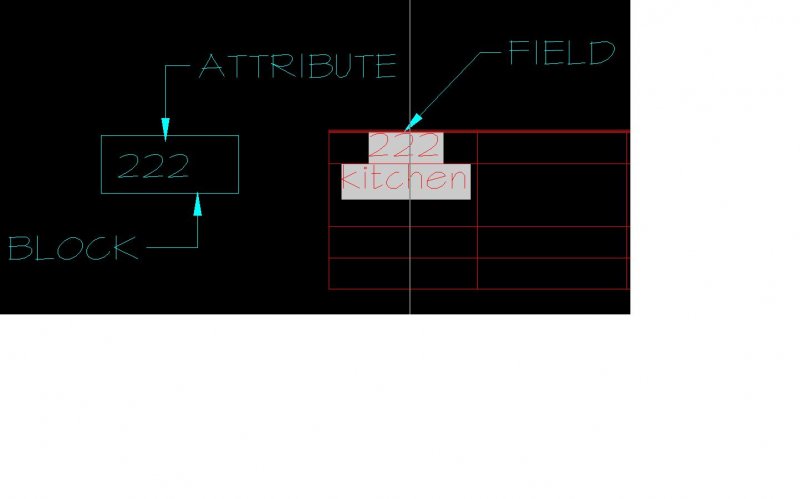

Marc5 Posted August 27, 2010 Share Posted August 27, 2010 How do you make a room space / tag so it will be added to the room finish schedule? Thanks, Marc Quote Link to comment Share on other sites More sharing options...
BIGAL Posted August 30, 2010 Share Posted August 30, 2010 Make a block with attributes Also question a bit vauge Quote Link to comment Share on other sites More sharing options...
qball Posted August 30, 2010 Share Posted August 30, 2010 see this pic. It's ugly, but I think you get the idea. I think you had a similar post elsewhere. used Block Attribute Definition Table Field Update Field Quote Link to comment Share on other sites More sharing options...
Marc5 Posted September 1, 2010 Author Share Posted September 1, 2010 Thanks. I can now change room name and room number in the plan and it updates in the schedule or other-way-around. Can the schedule be auto populated from entries I assign to the room tag, such as: wall material, wall finish material, floor finish etc.? Also, how do I cahnge the font of the room tag from auto cad default to what I want? Thanks, Marc Quote Link to comment Share on other sites More sharing options...

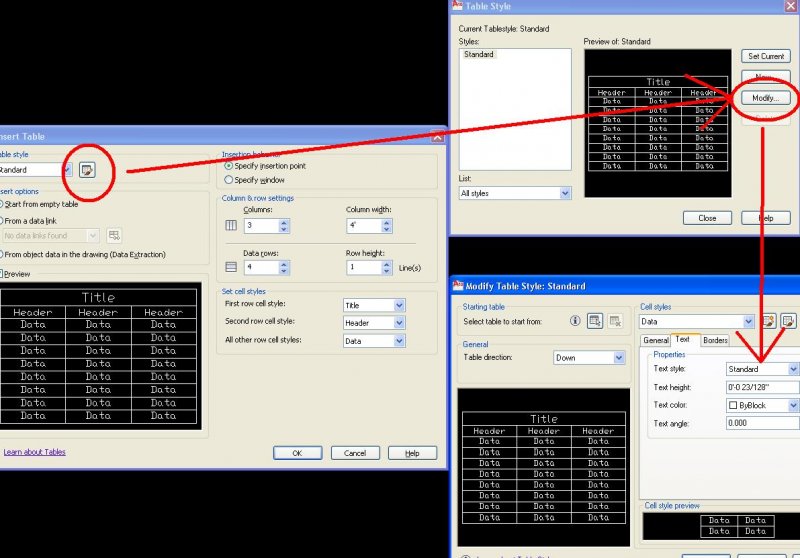

qball Posted September 1, 2010 Share Posted September 1, 2010 font: type Table, click the little paintbrush icon next to Table Style Standard. attaching materials to rooms? beats me. Sounds like more of a Revit thing. Quote Link to comment Share on other sites More sharing options...
Marc5 Posted September 1, 2010 Author Share Posted September 1, 2010 Thanks for the info. I did change the font of the room tag but back into it. I was unable to follow your suggestion to the tee. What I did, once in the text editor I changed ALL text styles that I thought would be associated with the room tag to Arial Narrow. Thanks Again, Marc Quote Link to comment Share on other sites More sharing options...
qball Posted September 1, 2010 Share Posted September 1, 2010 check the screen shot. I assumed that you had already set up a custom Text Style for your project. (Shown on pic as "Standard") Quote Link to comment Share on other sites More sharing options...
Marc5 Posted September 2, 2010 Author Share Posted September 2, 2010 I will try to find the Modify Table Standards. I just started working in 2010 last week. Jumped to '10 from '04. Any other advice is welcomed. Thanks, Marc Quote Link to comment Share on other sites More sharing options...
