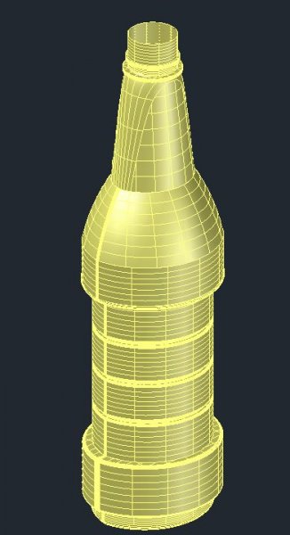

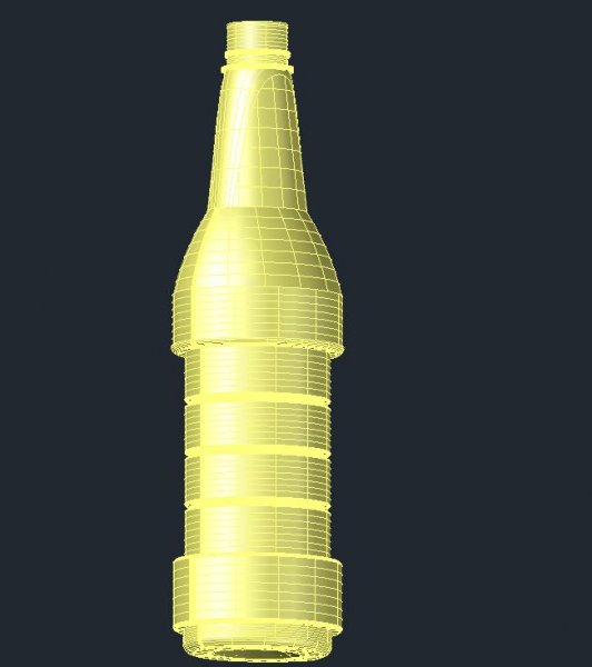

zeekay Posted September 18, 2010 Author Posted September 18, 2010 Finally I model this bothe from the help of surface modeling Or you can say its a Hollow bottle and no thickness. But i can model like Solid. I wanna do in solid bcoz surface bottle did'nt give me massprop exactle which i want to calculate in ml Quote
dayslife Posted September 21, 2010 Posted September 21, 2010 Finally I model this bothe from the help of surface modeling Or you can say its a Hollow bottle and no thickness.But i can model like Solid. I wanna do in solid bcoz surface bottle did'nt give me massprop exactle which i want to calculate in ml [ATTACH]23149[/ATTACH] [ATTACH]23150[/ATTACH] really i need the steps and all calculation to do this bottle if any one can do this i will be so greatful to him Quote

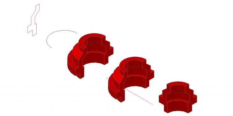

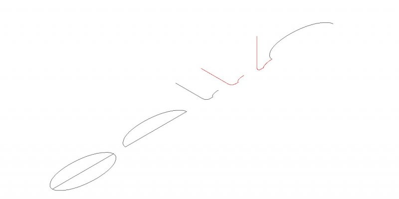

ReMark Posted September 24, 2010 Posted September 24, 2010 Solid Demo - Image 1 Zeekay: For my demo I used an ellipse but the same techniques could be used for a lemon shape. And before anyone gets all worked up about the method used I offer this caveat. This is but one way to achieve the results. I'm positive there are at least two other ways of doing the same thing, more efficiently or with different commands. There you go. Satisfied? In the first image, starting from the left, I've drawn my ellipse (Pellipse=1). Next I trim half of it away. I create my polyline profile (in black). I offset my profile (in this case the distance, in inches, is 0.007) and attach a small polyline to each end and use the Pedit command to join everything together. New profile now shown in red. Finally, I reposition this profile in relationship to my intended path. Quote

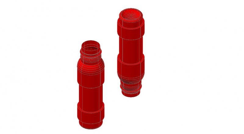

ReMark Posted September 24, 2010 Posted September 24, 2010 (edited) Solid demo - Image 2 There are three solids in this image. The first one consists of the red profile that was "swept" along the path of one-half of an ellipse. The middle solid was created by using the mirror command on the first object. The mirrored object is shown in blue. I then added an extruded (0.007") ellipse (shown in green) to fill in the hole. The last solid is shown upside-down so you can better visualize the bottom. At this point we could use the Union command to make all three solid objects one entity. Note: If we invoke the Massprop command and select the first half of our object (red) AutoCAD returns: Mass: 0.5988 Volume: 0.5988 Edited September 25, 2010 by ReMark Quote

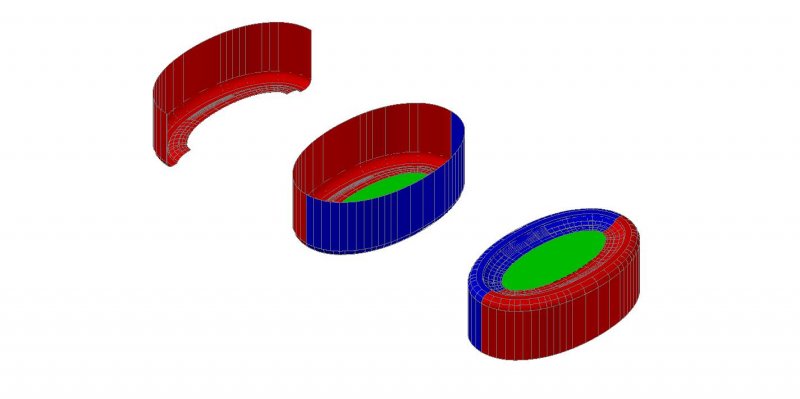

ReMark Posted September 24, 2010 Posted September 24, 2010 The object below was created in much the same way as the last one I made. A profile was made using a single polyline that was then offset and joined at both ends with a short, horizontal polyline. The full profile, shown in red, was swept around a half circle shown in blue. The resultant object was copied and a single horizontal cut line, in magenta, was added. I used the Slice command with the XY option to slice the object. Unless my new prescription glasses were made using the wrong lenses the object looks plenty solid to me and AutoCAD identifies it as a solid. If I had made the object using surfaces then I would agree the space between the outside and inside faces would be hollow. I hope this clears up any confusion on your part zeekay. Quote

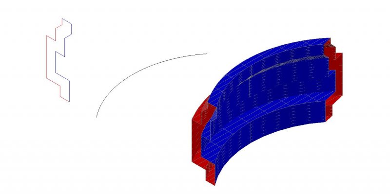

ReMark Posted September 25, 2010 Posted September 25, 2010 zeekay: For your education. The image below was made by extruding two separate polylines, one red and the other blue, along a "path" defined by the arc (black). As one can clearly see there is a void between the two surfaces. This is why I did not use this technique creating my two previous images. It would be considered "hollow". Do you understand the difference now? Note: If we invoke the Massprop command and select the above objects AutoCAD responds: No solids or regions selected. Quote

ReMark Posted September 26, 2010 Posted September 26, 2010 Comments? I'm not looking for comments but thanks anyway. I'm hoping you'll finally understand the difference between using solids and surfaces. I'm also hoping you'll recognize that just because a profile is created using the offset command that it doesn't necessarily mean the wall of any given object is going to be hollow when I've shown that it is possible to have it be solid through-and-through and for the Massprop command to be able to derive useful information from it. Quote
