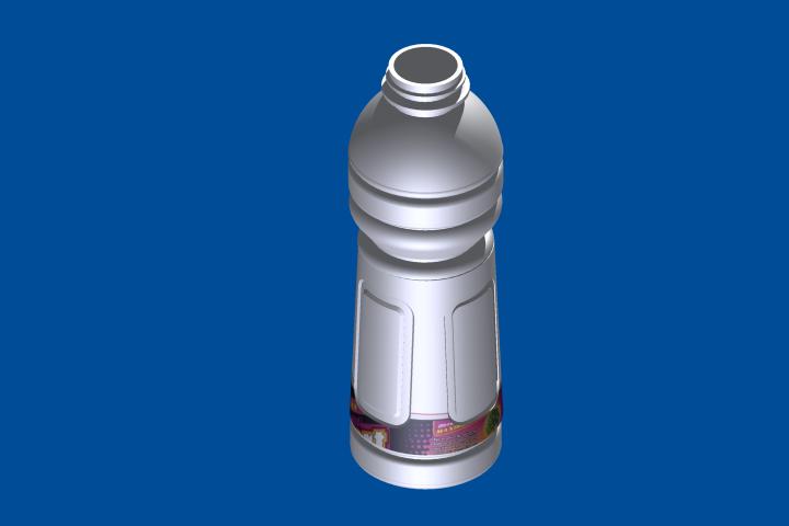

JD Mather Posted September 16, 2010 Share Posted September 16, 2010 hello my friend. your bottle is a solid or be a thickness wall? (JDMather) can you explain more the process that you use to make the blue bottle please? Q1. Wall thickness. Q2. Autodesk Inventor. Quote Link to comment Share on other sites More sharing options...

chombopolitan Posted September 16, 2010 Share Posted September 16, 2010 thanks you very much. but i have a problem when i try to emboss the bottle, when i create a tickness wall whit the brand of the bottle for example the emboss of coca cola in the bottle. in your bottle you have a ribs. how do you do that? sorry about my english. Quote Link to comment Share on other sites More sharing options...
JD Mather Posted September 16, 2010 Share Posted September 16, 2010 What program are you using? AutoCAD? Imprint and perhaps xedges will be of use to you - but this all gets very complicated in AutoCAD compared to Inventor. Zip and attach your file here. Quote Link to comment Share on other sites More sharing options...
chombopolitan Posted September 16, 2010 Share Posted September 16, 2010 (edited) i have a problem with the file cause its too big 3Mb, i use autodesk inventor 2011. i have to add a emboss of the brand and put a decal in the bottle but i have 2 problems. 1. I cant make a thickness wall and emboss. 2. I cant put the decal in the bottle. you put a rib in your bottle but i cant do that the emboss its like the gatorade bottle but i cant do that in a thickness wall Edited September 16, 2010 by chombopolitan no have the attacth Quote Link to comment Share on other sites More sharing options...

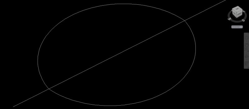

zeekay Posted September 18, 2010 Author Share Posted September 18, 2010 In the 1st Capture image u seen the red Bottle shape which i create closed polyline outline and the white line is the plan of the bottle which is not eclips it a lemon shape. Quote Link to comment Share on other sites More sharing options...

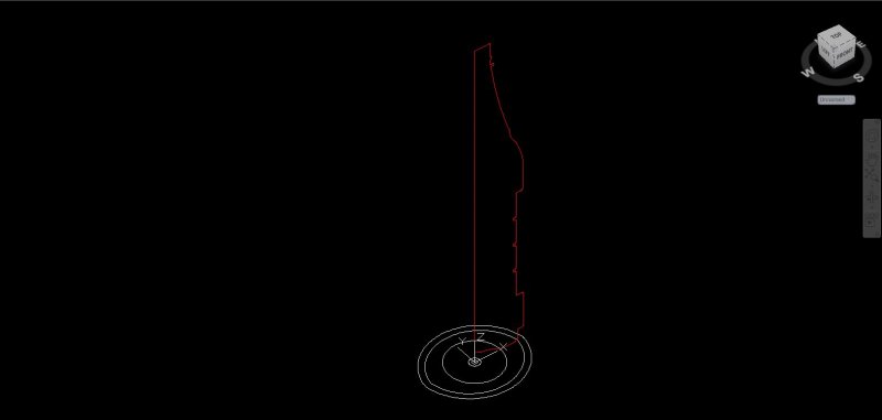

zeekay Posted September 18, 2010 Author Share Posted September 18, 2010 Full View Quote Link to comment Share on other sites More sharing options...
zeekay Posted September 18, 2010 Author Share Posted September 18, 2010 In this Image I trim the Lemon Shape from the center and Use command and join the arcand the line to create ployline. Quote Link to comment Share on other sites More sharing options...

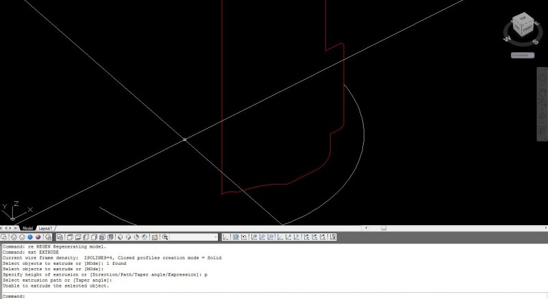

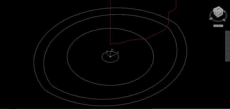

zeekay Posted September 18, 2010 Author Share Posted September 18, 2010 In the 4th Image I use the command to make the red bottle shape on this path but its not done see the command editer of the error Quote Link to comment Share on other sites More sharing options...

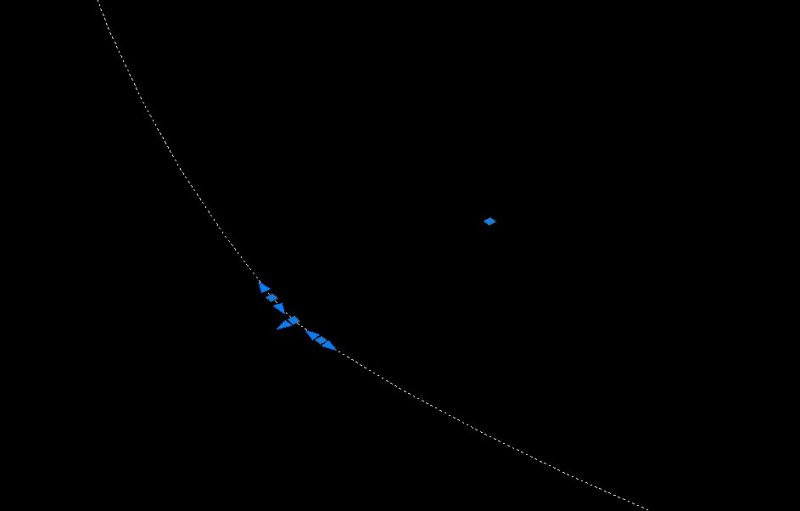

zeekay Posted September 18, 2010 Author Share Posted September 18, 2010 Now Tell me How can i create this Red Bottle Shape on this Lemon like Plan . This is the close view of the curve of plan Quote Link to comment Share on other sites More sharing options...
