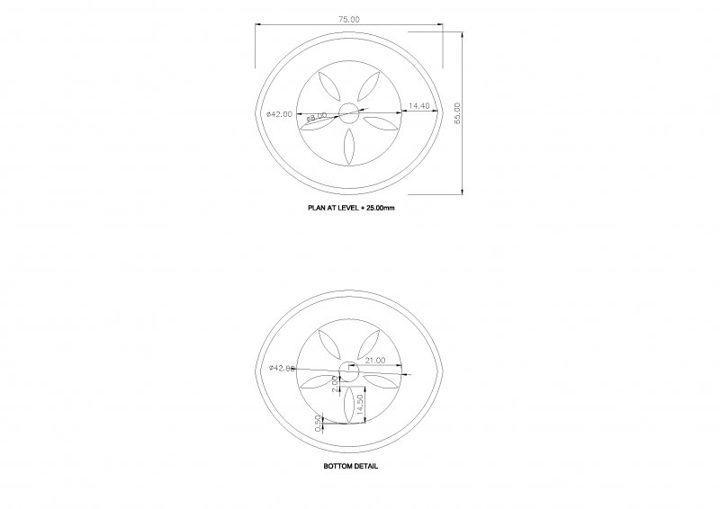

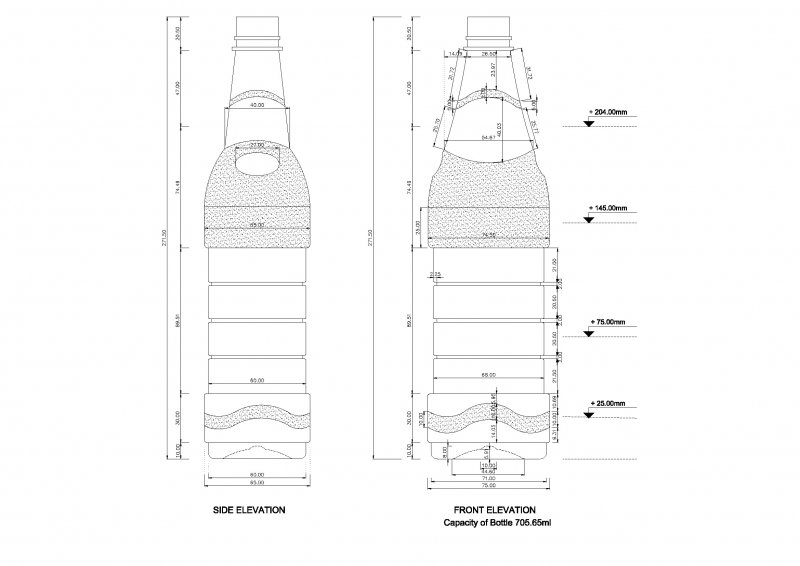

zeekay Posted August 27, 2010 Author Posted August 27, 2010 Sure Why Not. Its really good for me Bcoz Senior memeber JDM, ReMark and Dtaylor Help me. Here is Working Drawing and images If You can Make new thread Call Name ( Bottle Tutorial) that will be good for all visitors:) Umer(Working).dwg Quote
