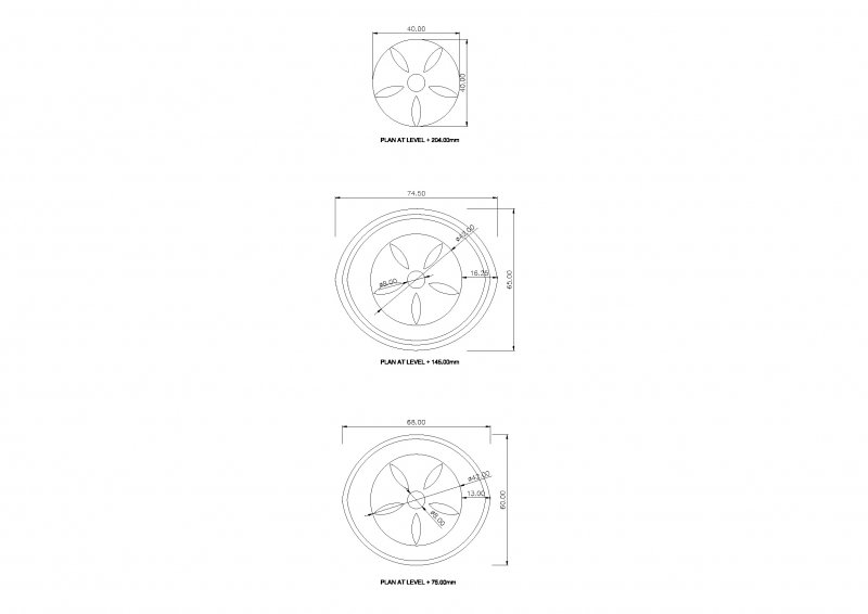

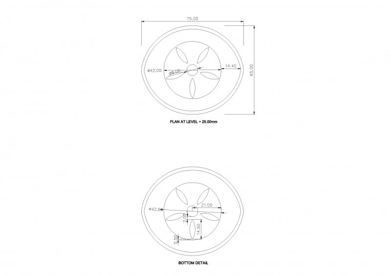

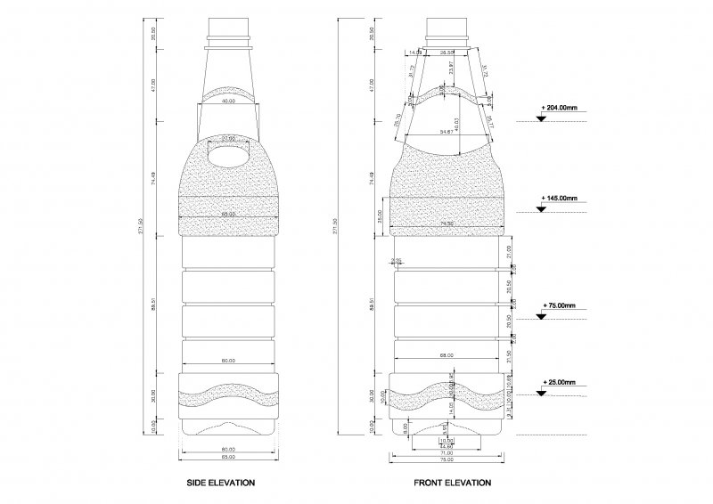

zeekay Posted August 24, 2010 Posted August 24, 2010 (edited) I draw the bottle plans and elevation which i already attached. My Questions : 1- How can i model its 3d? 2- How can i Calculate its volumne in mililiters I donw want from you to Model in detail like imeages I just want to know How can i Calculate its Volume in mililiters Bottle plan.dwg Edited August 24, 2010 by zeekay Quote
dtaylor Posted August 24, 2010 Posted August 24, 2010 I'm not sure how exact you want the bottle to be, for example the 5 bumps on the base. But quick and easy either draw the outline of half the bottle and convert that to a closed polyline and revolve 360 degrees or use circles at specified heights and diameters as cross sections to loft them. Both methods will produce a solid that you can then just use the massprop command on Quote
dtaylor Posted August 24, 2010 Posted August 24, 2010 scratch that, the bottle isnt round. you could still draw cross sections and loft them or maybe use guide lines to loft Quote
ReMark Posted August 24, 2010 Posted August 24, 2010 Please go back and review your bottle plan drawing. I believe you have duplicates of many of the lines overlaying each other and at least one instance of an arc that was not trimmed properly. Until you clean it up you will not be able to continue on. Quote
dtaylor Posted August 24, 2010 Posted August 24, 2010 massprop this maybe Bottle plan.dwg It'll be close atleast Quote

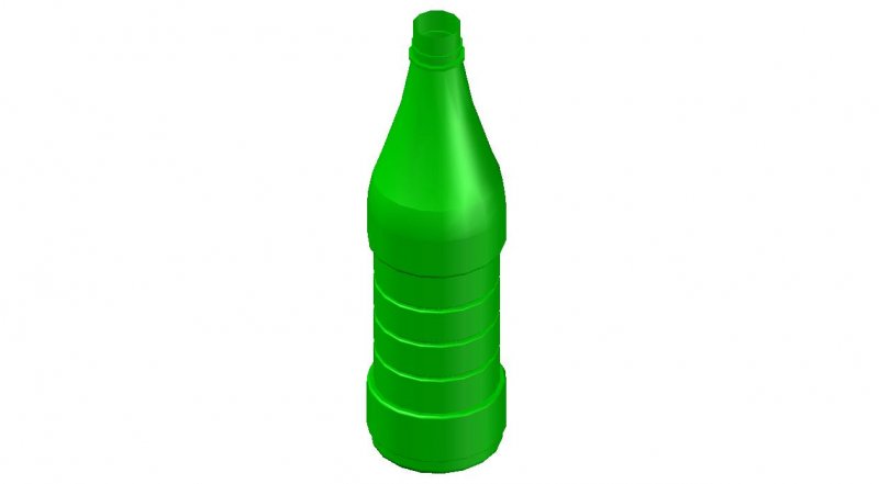

ReMark Posted August 24, 2010 Posted August 24, 2010 I created my version of the bottle using the SWEEP command based upon the OP's geometry after correcting for the errors I mentioned previously. Quote

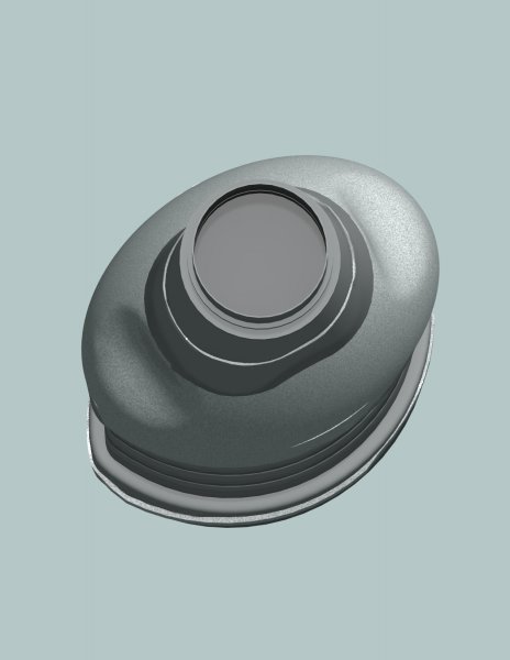

dtaylor Posted August 24, 2010 Posted August 24, 2010 ya, i just turned that lemon shape into a closed polyline, then just scaled it down to what i needed at various points along the bottle. once i got to the top of the neck i just placed circles. then just lofted everything in the correct order. i just did everything roughly so its not perfectly exact buts its a close approximation and can lead zeekay in a direction if he wants more precise results Quote
dtaylor Posted August 24, 2010 Posted August 24, 2010 @ReMark: is your bottle cylindrical or lemon? Quote

ReMark Posted August 24, 2010 Posted August 24, 2010 @ReMark: is your bottle cylindrical or lemon? It is cylindrical. Like I said I used the OP's bottle plan drawing. I did not significantly change any geometry. Duh! Now I see what you were referring to. I completely blew by the bottom view of the bottle the OP first posted. It does appear to be out of round for some reason. I wonder if that is intentional? Quote

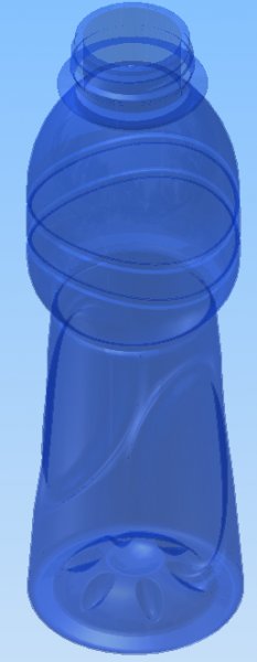

zeekay Posted August 24, 2010 Author Posted August 24, 2010 dtaylor: U done very nice with the shape of lemon as we see in plan but u just miss the bottom dome download my new attachment Umer(Working).dwg Quote
dtaylor Posted August 24, 2010 Posted August 24, 2010 ya, i was just roughing it out to give you a possible direction to go in. Figured I'd let you do the detailed work. also the base should be cylindrical. Quote

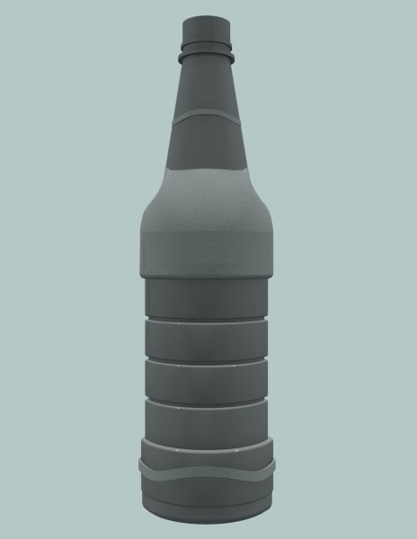

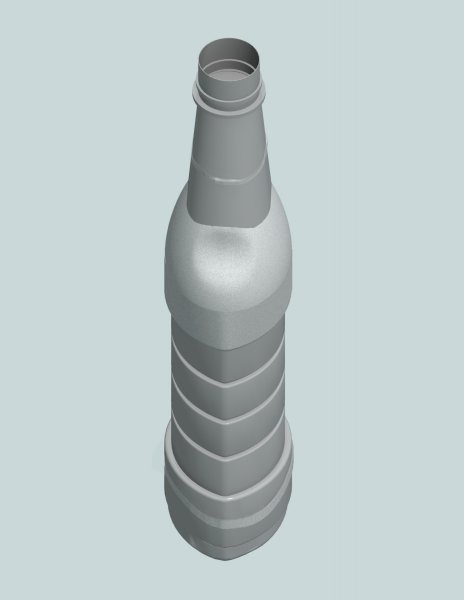

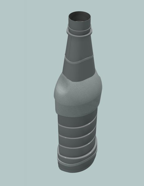

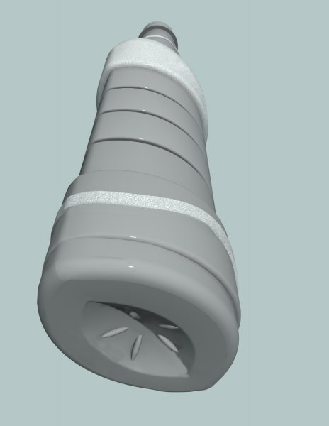

zeekay Posted August 24, 2010 Author Posted August 24, 2010 I already model this bottle in Autocad and with the help of 3dmax2010 Here is the attachment which is not good i know and help me Quote
