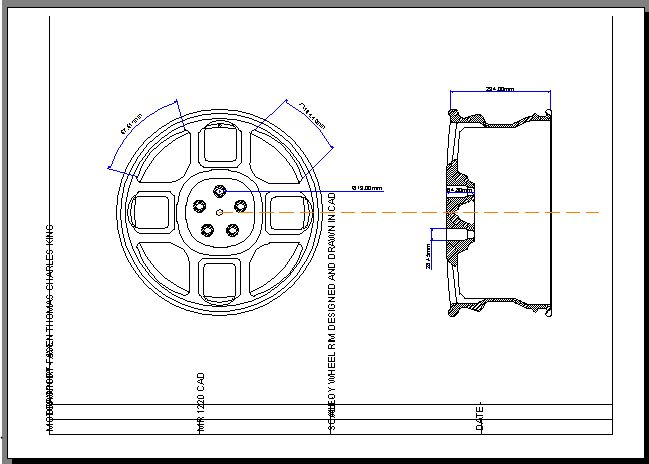

dubking Posted August 23, 2010 Share Posted August 23, 2010 (edited) Hi guys, i have had to learn CAD this weekend to pass my degree, i had to create an alloy wheel front and side profile views, my problem is this - i have created the wheel in model space but when i goto layout 1 / paper space and insert my title block and border, then insert my viewpoint of the wheel, and goto page setup, preview, it only shows the wheel, and without the viewpoint border / title block / border. im a total noob at CAD, but need to do this to pass my degree. any help would be gratefully received. (autocad 2011 lt) Peace Edited August 23, 2010 by dubking cad version Quote Link to comment Share on other sites More sharing options...
hoss Posted August 23, 2010 Share Posted August 23, 2010 In page setup, in the plot area, under what to plot choose window from the drop down box, select the bottom left corner and top right corner of your title box, also make sure you have selected the right size paper under paper size and right scale under plot scale ( or fit to page if scale is not required) Quote Link to comment Share on other sites More sharing options...
Cad64 Posted August 23, 2010 Share Posted August 23, 2010 Check to make sure you didn't put your title block on a layer set to "No Plot". Quote Link to comment Share on other sites More sharing options...
SPARKY77 Posted August 23, 2010 Share Posted August 23, 2010 make sure the template is not on the default layer as this does not plot Quote Link to comment Share on other sites More sharing options...
rkent Posted August 23, 2010 Share Posted August 23, 2010 make sure the template is not on the default layer as this does not plot .... DEFPOINTS layer as this does not plot. Quote Link to comment Share on other sites More sharing options...

dubking Posted August 24, 2010 Author Share Posted August 24, 2010 hi guys, thank you very much for your help and advice, i have managed to create a title block, ive inputed the view as well, looks nice and tidy, but, when i goto plot, (using a lexmark P6350) the text from my title block is set across the page portrait style, whereas the rest of the image is landscape (how i want it). and it also cuts off the top line. I have literally till tomorrow morning to post this piece of work vie royal slug mail to my uni. a screen shot, jpeg format is included! many thanks for the replys and help and advice!!! Quote Link to comment Share on other sites More sharing options...
dubking Posted August 24, 2010 Author Share Posted August 24, 2010 found the solution as such, plotted as jpeg to net file, and it prints fine!! whoop whoop! me thinks CAD is my future career after many failed career attempts! cheers to everyone who helped! peace Quote Link to comment Share on other sites More sharing options...
