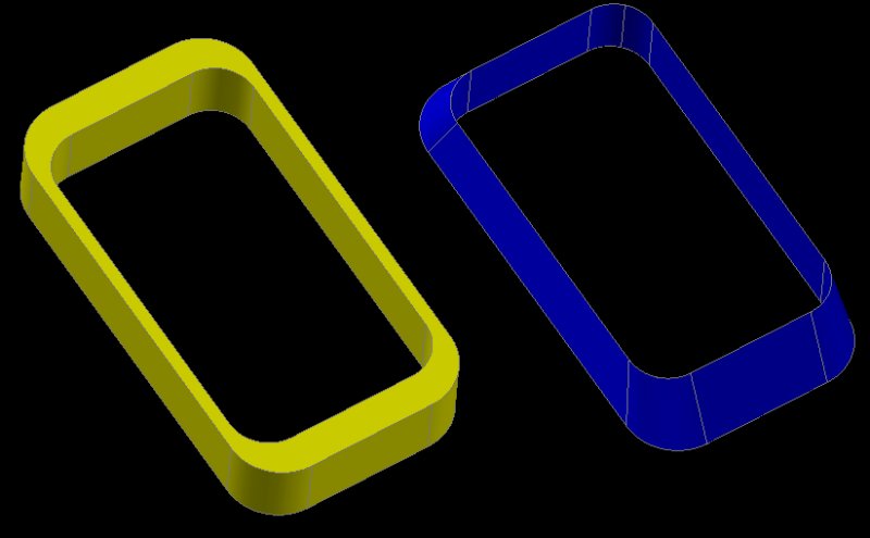

1SLwLS1 Posted August 20, 2010 Posted August 20, 2010 Background: At the current time I only have AutoCAD at work which is where I ran into a problem. At home, I got bupkis, downloading viewer and student inventor 2011 as I type. I am trying to model a trim piece from my car. Somewhat complicated part, as nothing is standard no 16" fractions, just a bunch of weird measurements with the calipers. Using standard AutoCAD 2010. Problem: I am trying to draw a complicated solid. Until I can either upload a .pdf, .dwg, or student .dwg, I will try my best to describe it. Start off with a rectangle measuring 0.79" x 1.39" and then fillet the corners with a radius of 0.14" on all corners. I then offset the long sides by 0.047" and offset the short sides by 0.130". For the corners of this new, larger rectangle, I draw circles with a radius of 0.20". For location, I put the quadrants at the end points of the short side offsets. Since, the offsets between the big and large rectangle are not the same, I have to extend the long side offsets to meet the quadrants of the circles. So now I trim them up, make them regions, with the large circle completely encasing the smaller one, (2) different regions. I extrude them up the Z axis by 0.270" Here comes the challenge, I am trying to find a way to taper from the bottom edge (on the x-y plane) on the larger rectangle, to the top edge on the inner rectangle. AutoCAD will taper the flat surfaces if I select them individually, but looses it's marbles when I tell it to taper the curved face. I assume this is because the radii of the circles are different, as well as the intersection points of the different planes. Still with me? If not, I am working on posting a clarification drawing ASAP! I think this shape may be too complicated for AutoCAD to render, not sure though... Quote

1SLwLS1 Posted August 21, 2010 Author Posted August 21, 2010 My goal is to taper the outside faces from the bottom to the top of the inside faces. Do I make sense now? Let me know if this is not in the right subsection of the forums, this made the most sense to me, 3D Modelling. Traction Control Plate Forums.dwg Quote
kencaz Posted August 21, 2010 Posted August 21, 2010 I think loft is your best bet here. Offset your inside rectangle +Z .27, loft using "cross sections" option then "press-pull" the top section right down through to remove the inside. You'll have to close your loft sections or you will get surfaces and not a solid. Good Luck Quote

1SLwLS1 Posted August 21, 2010 Author Posted August 21, 2010 Great, so I finally got loft to work properly, realized I could select the same line twice to close the object and then convert it to a solid. Once I converted it to a solid, I subtracted it from the panel to get the results I wanted. I would attach the finished product, but it is over the forum limits. If I host the finished product at a website, I will link it here on Monday. Thanks for your help Quote

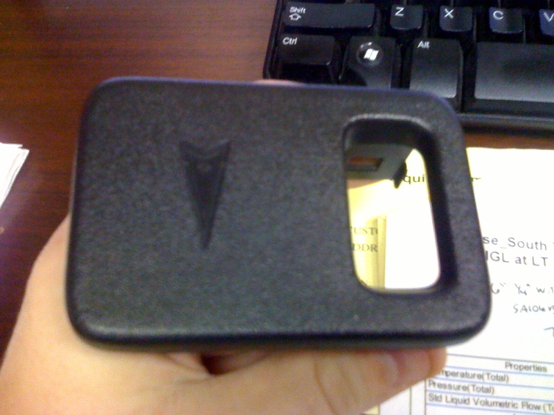

1SLwLS1 Posted August 23, 2010 Author Posted August 23, 2010 (edited) Here is the finished product, kinda of... [] I am now trying to figure out how to add a texture of molded ABS plastic to the outer surface only in various places. I will upload a picture of the actual part as well. Edited August 24, 2010 by fuccaro Quote
fuccaro Posted August 24, 2010 Posted August 24, 2010 Sorry 1SLwLS1 We have a rule here: you can't post hyperlinks until your post count is bellow 10. Try to post an image. Quote
1SLwLS1 Posted August 24, 2010 Author Posted August 24, 2010 Oh ok, I am going to assume you meant above 10? Either way, here is a .pdf of the piece and a quick crappy iPhone picture of the piece Traction Control Plate2.pdf Quote
